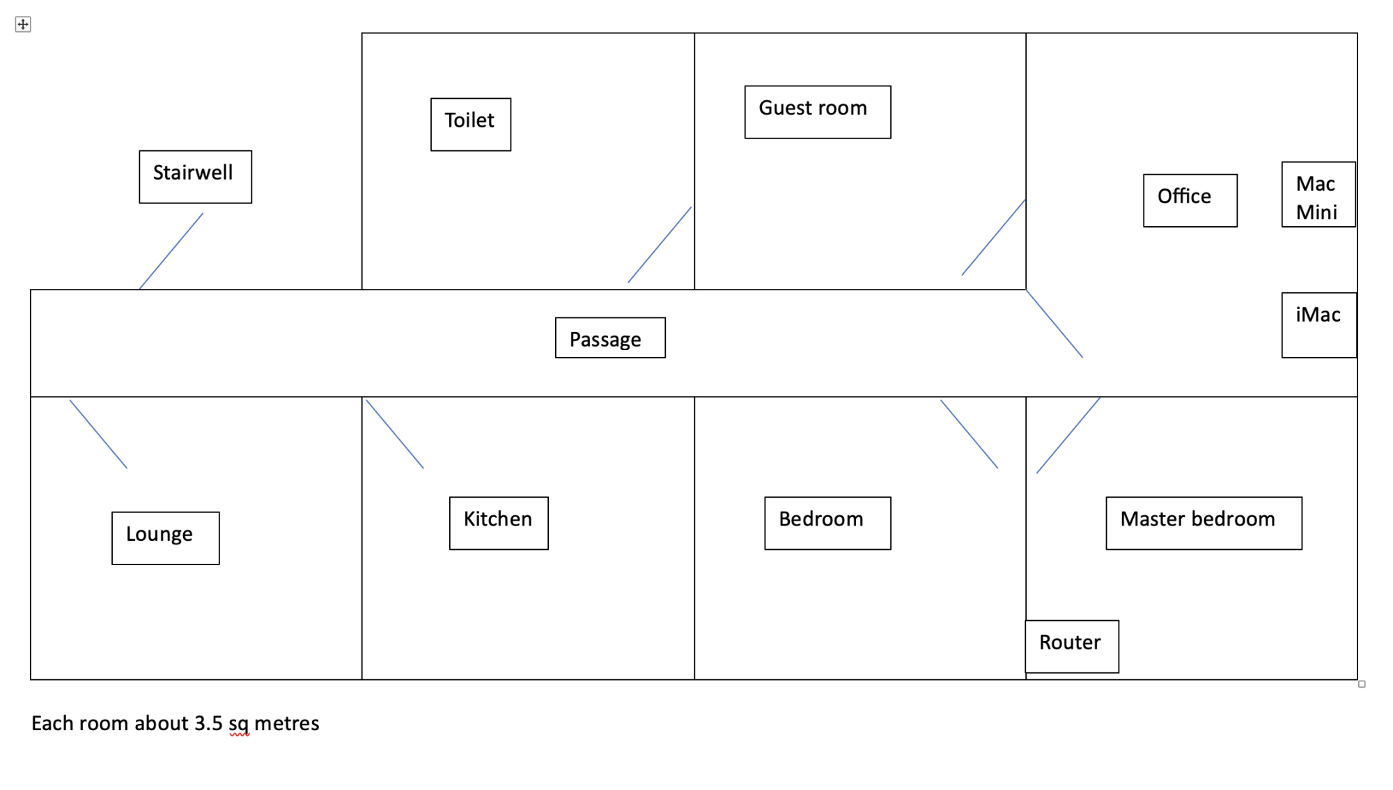

I am confused (easily done!). I want to extend my home wifi networks as to be able to use my newly acquired MacBook Air in most of the rooms in my apartment. I've looked at the TP link range and am confused with regard to which one to choose. My budget would be about £120. The plan of my fifth floor apartment is below. Can anyone suggest which of the numerous TP Link systems I should use?

Honestly, as for me you should check out routers with Wi-Fi 6 standard. As for Mesh systems, you'd have more than 3 stations, and ideal may be TP Link X series, but the price bites. If you have or can place the powerline grid, then P series. If no -- M4, M5 series.

If you DON'T have a residential gateway, you might consider a 2-piece mesh system. The base unit would go next to or near your ISP input. The satellite would go down towards the other end of the apartment (lounge?)...
Many thanks to both. A good point, Fisherrman - I have a Vodafone router and it generally provides good local coverage. I'll try my MacBook Air and see how far it will work from the router. As you can guess, long apartments like ours with walls in between do present a bit of a problem. Meanwhile, looking at appltech's advice, if the MacBook Air won't perform, I would guess that I will have to spend a little more. TP Link have a good press and a wide range but one is looking at two to three hundred pounds/euros/dollars. But then, I've just splashed out nearly two grand on the MacBook Air!

What's the square footage of your appt?
Mine is 2700sqft spread over two floors. I bought two old Asus ac 86u routers for around $120 total, flashed third party Merlin firmware to turn them into a mesh. Placed them on opposite ends of appt. I get 250 to 450+mbps everywhere (i have 500mbps fiber)
I don't use the router from the ISP which saves me the $10 a month rental. One of the routers acts as gateway, the other is a mesh node. The second router is connected via Ethernet, though. If your appt isn't wired for Ethernet, you'll have to go with something like an Ethernet over power or Ethernet over coax kit, which does cut down on the speed.
You're not getting WiFi 6 speed and features with this setup, obviously, but I've found it an economical and workable solution
