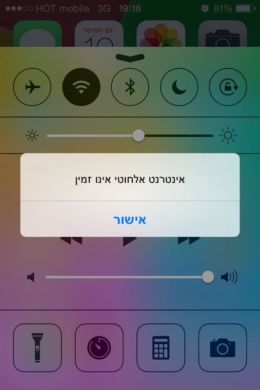

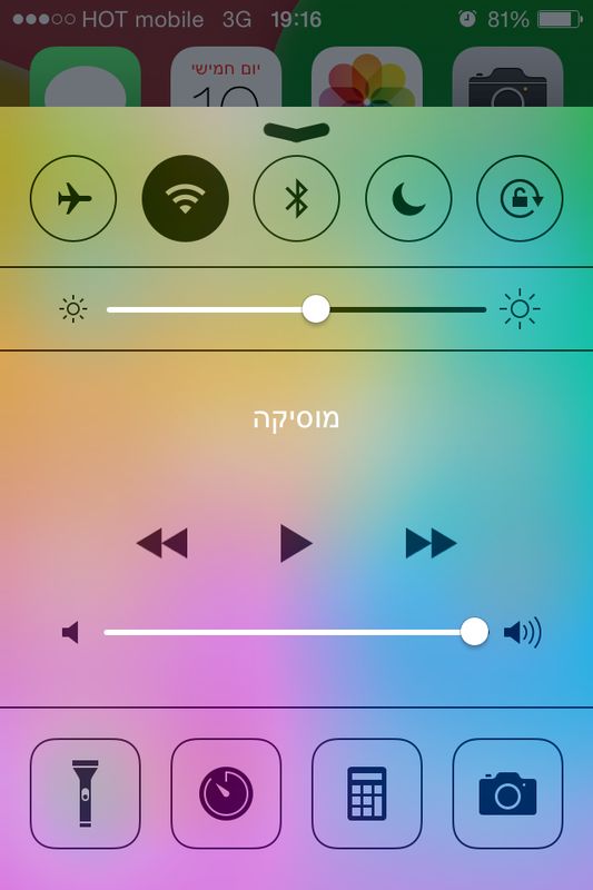

I have an iPhone 4S nearly two years and now suddenly the wireless Internet has not available.
I've reset network settings, boot and hard reset. Nothing solved the problem.
