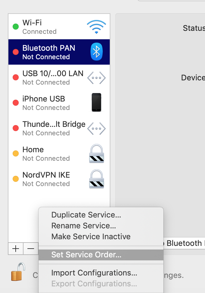

At work my main wi-fi signal is poor (old building with thick walls) and so I have a couple of internet dongles (O2 and 3) that I can use when I can't get the main wi-fi, however recently the connection has been playing up. My 2017 Touch Bar MBP running Mojave will connect to the dongles, but then it won't connect to the internet despite the display on the dongles saying they're connected. I have the same issue tethering to my iPhone 11, however if I connect my iPhone 11 to the computer via the USB cable it will then connect to the internet. Strangely neither dongle will work even if I plug them in via USB.
Any ideas what the issue is and how to solve it?
If I understand correctly, you have a few issues.
1) The USB 3G/4G dongles are not consistently connecting to the network (probably nothing to do with wifi).
2) You wifi signal between your iPhone and MacBook seems to be problematic.
For 1) I would ensure that you go and disable wifi before using the USB device. It's possible that the wifi signal is strong enough that the MacBook tries to use it in preference to the USB, but not strong enough that it can reliably carry data.
For 2) It could be an interference issue?
USB can interfere with wifi, ironically, in the 2.4Ghz space. As can microwave ovens and fluorescent lights. So it's possible that if your USB 3G/4G device is not shielded well it's compounding the issue but also crapping all over your wifi signal. In addition, while you have your USB and Wifi active, you can go to Networks from System Prefs, click on the little cog, and Set Service Order and ensure that the USB adaptor is higher than your wifi.
I would check whether your corporate wifi is 2.4Ghz or 5Ghz or both, and see if you can force 5GHz. At home I have separate SSIDs for 2.4Ghz and 5Ghz and can force 5Ghz by attaching to the 5Ghz SSID. Of course, 5GHz is more susceptible to degradation from thick walls etc. But it will not be affected by USB.
The connection between the iPhone and the MacBook - I don't know of a way to force the frequency there. I would also see if you can set the Service Order there too.

Thanks for your reply, much appreciated. To clarify, the MBP is connecting to the dongles via Wi-Fi but it can't access the internet. Now my initial thought was that it was the dongle, but I get the same behaviour with the second dongle and also my iPhone, and all 3 devices show they are connected to the internet and I can also use the internet on my phone itself. However, my MBP will connect to my iPhone AND the internet if the phone is connected via the USB.
When I've gone into the Wi-Fi preferences as you've shown in your picture it shows wi-fi connected and a green dot, but also above that the direct IP is also showing as connected with a green dot, which is not the case when I'm connecting to 'normal' wi-fi.
Yeah that does change things. It is still worth looking for a 5GHz option if one is available.

I haven't tried the 5Ghz option yet, but I'm not longer at work. In terms of other wi-fi networks it's fine, it's mobile networks that seem to be the issue, whether via dongle or iPhone.

Are you saying your dongle says it is connected, but your are unable to connect to a website a browser? If so, go to System Preference | Network. See if you have one entry for Wifi (that should be the built in unit) and another for your Wifi Dongle. If you do have both, try turning off the built in Wifi and see if that helps. I am sort of guessing at this. You might also check and see if there are any instructions for setting up the dongle on a macbook.
Well time off seems to have fixed my issues, both dongles are now working again. Whether the Mac reset something with being turned off for a week I've no idea but both now work. Having gone into the network settings it just has on wi-fi but IIRC I think I do recall seeing two previously so maybe that was it. If it stops working again I'll be sure to check that as the first thing I do.
