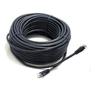

It's called a 100' Ethernet Cable and costs $10.91 on Amazon.
LOL 😀 . Nobody wants to run cable, but cable is always 100% better than WiFi in every way except convenience.
