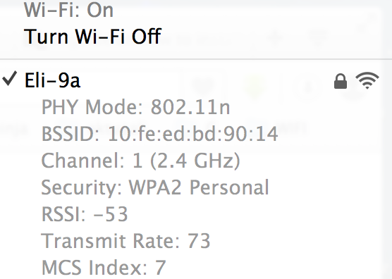

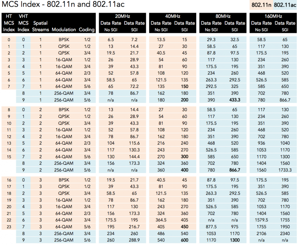

Looking at the pic above, do you You think MCS Index is important? Why is my MCS Index only 7? What is Your number?

MCS index doesn't matter all that much(most of this will be transparent and your connection is so straight forward that its value is limited). My MCS index is 8 on a Wireless AC connection running at a link speed of 1000mbps, with a channel width of 80mhz(you can find this on the "Scan" section of Wireless Diagnostics, scroll right...). In the scan section if the width shows as 40mhz transmitting, then that is the link width required to establish the connection, this is specified on the router broadcasting, not on the device connected(in order for the device to connect it MUST be capable of establishing that link width, whether one or multiple streams, but that would be a transparent process and would not be the devices issue short of outright hardware failure)

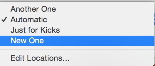

Have you changed the location? (System Preferences>Network>Location)The name of the location won't matter but if there is a system configured limitation this will typically resolve it.

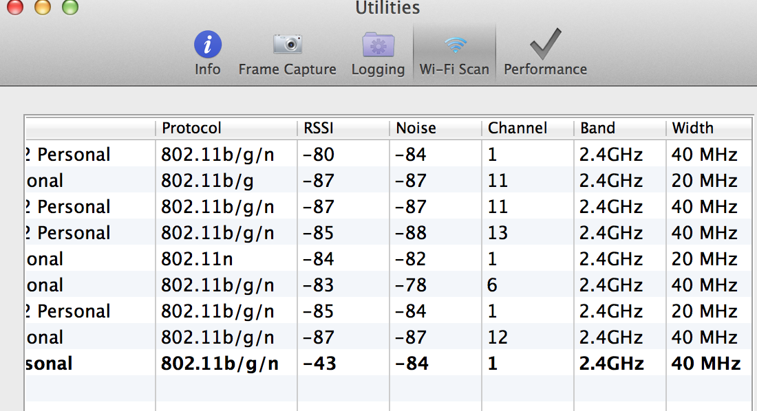

Image attached shows where width is listed in the Wireless Diagnostics Scan window..

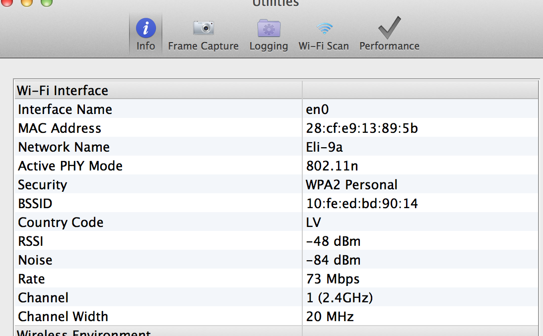

Here are the Network Diagnostics Scan window
This is Network Diagnostics Info tab
See my confusion about the Width?

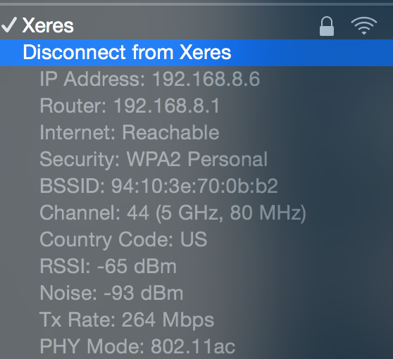

Hold option and click on your wifi menu... should show something similar to this... look at the width in the channel line.

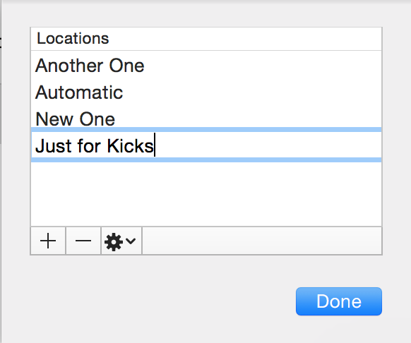

To be very clear about what I was saying about location, I was saying create a NEW location(Automatic is default, and arbitrary, you could create another called "manual" and it would work the same). System Preferences>Network>Location> Edit Locations, Hit the +, name it whatever you want, hit ok, make sure it is selected... if applicable hit apply after setting your new location... here are some images for reference..
Restart after doing this for the sake of argument. (My general school of thought with computers is to give them as few reasons to mess up as possible.)

My theory is that i am using one stream (suggested by MCS Index number) For 11ac, it is different.
Do you know how many spatial streams You are using? I think one. same as me, clearly. Is there a place in Mac to look at the actual spatial stream number in use?

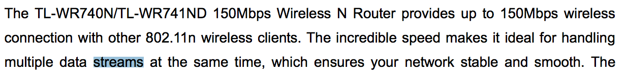

This is an excerpt from TL-WR740N manual:
So.. my Router supports multiple streams. Does my WIFI card as well? Or am I looking the wrong direction here..? Because for me it seems a matter of just finding a way for MCS Index to go to 15. Which is to say, find a way to enable second stream. OR other option: stay in MCS 7 one stream config, but Enable 40 MHz wide channel. Because my Link Speed 72 is the number in MCS 7 row and 20MHz column.

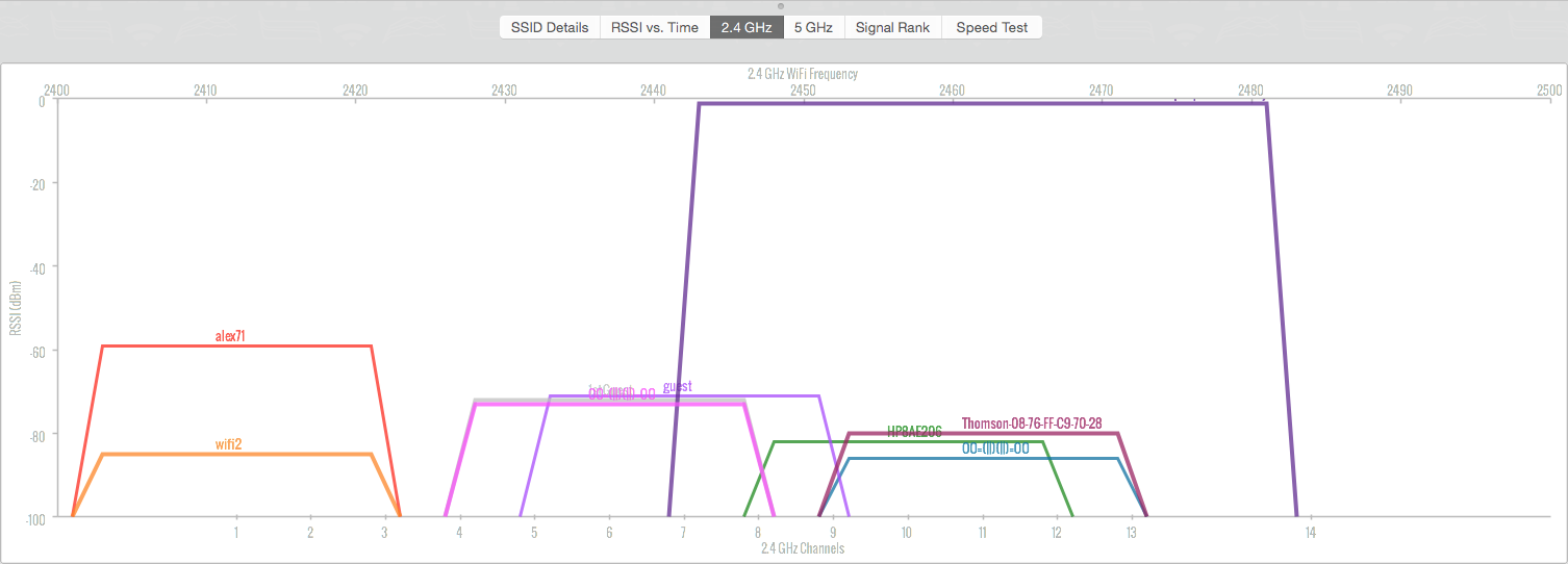

I don't follow your idea here, how would you do this? By adding second wireless card to your macbook? Actually you may be able to find a USB-wireless stick that supports wide channel on 2.4 band.
But at the end of

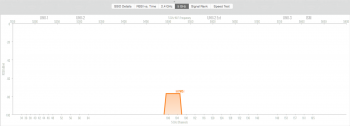

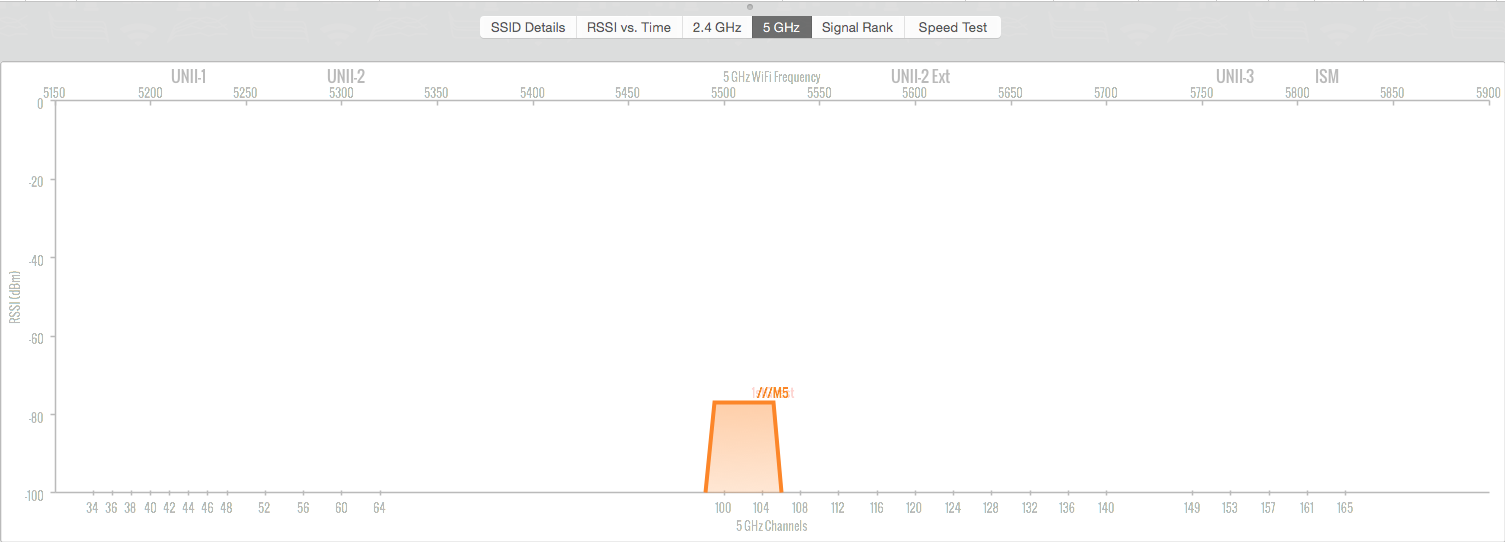

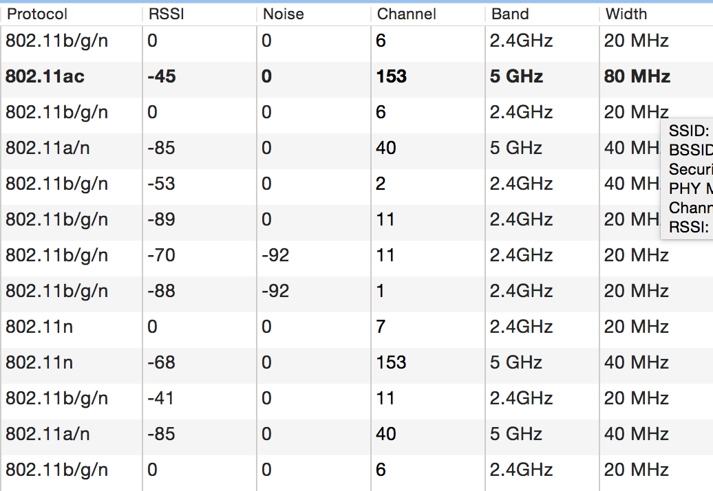

the day, you should ditch the 2.4GHz band as it is overcrowded anyway. (you can see the situation at my location from the attached pics)
