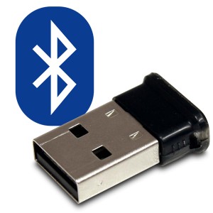

Some people just got themselves a cheap little USB Bluetooth adaptor and situated it so that it is closer to their mouse/keyboard and got much better results. Something like this:

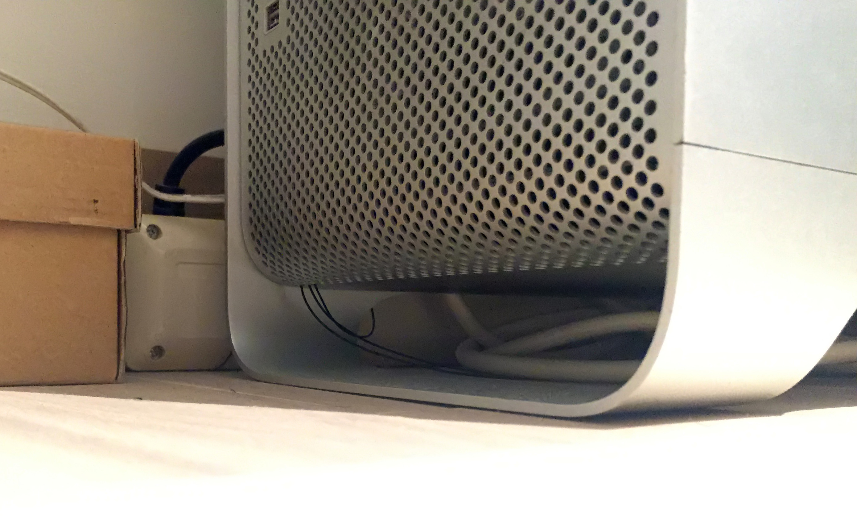

For your info, the holes on the cases are good enough to route the cables. Not necessary occupy a PCIe slot just for that.
View attachment 796188 View attachment 796189
Thanks Lou - yes, I'd seen someone else mention this elsewhere on the forum - I think they mentioned drilling into the case itself. I'm guessing the antenna will work the same whether it's mounted upright or just laying on the floor? Feels safer to mount it somehow.
That's the wifi antenna, not the BT one. The SMA connector next to it extend the BT cable, and then BT antenna (same model, anyway) is placed at a hidden place just about a feet away from the mouse at the optimum angle on the desk.

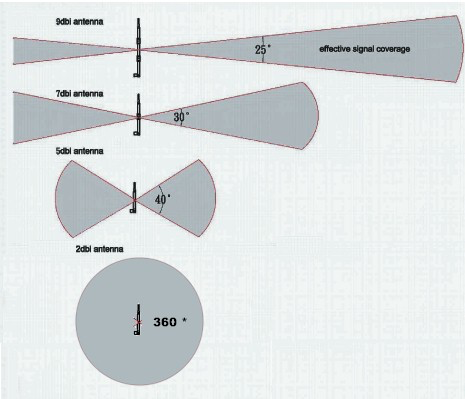

They are all 8 dBi gain antenna. And they are not randomly left on the floor / desk. The antennas are placed at the correct direction to make my mouse / router / Airdrop devices / etc stay at the effective single coverage zone.
I have no idea if mount them on something will be better or not. But obviously as long as I put them at a reasonable position (mainly outside the metal case) with correct direct. The wireless connections will be good.

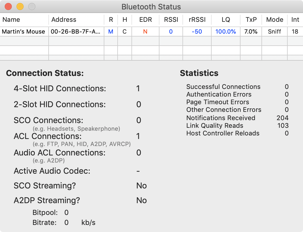

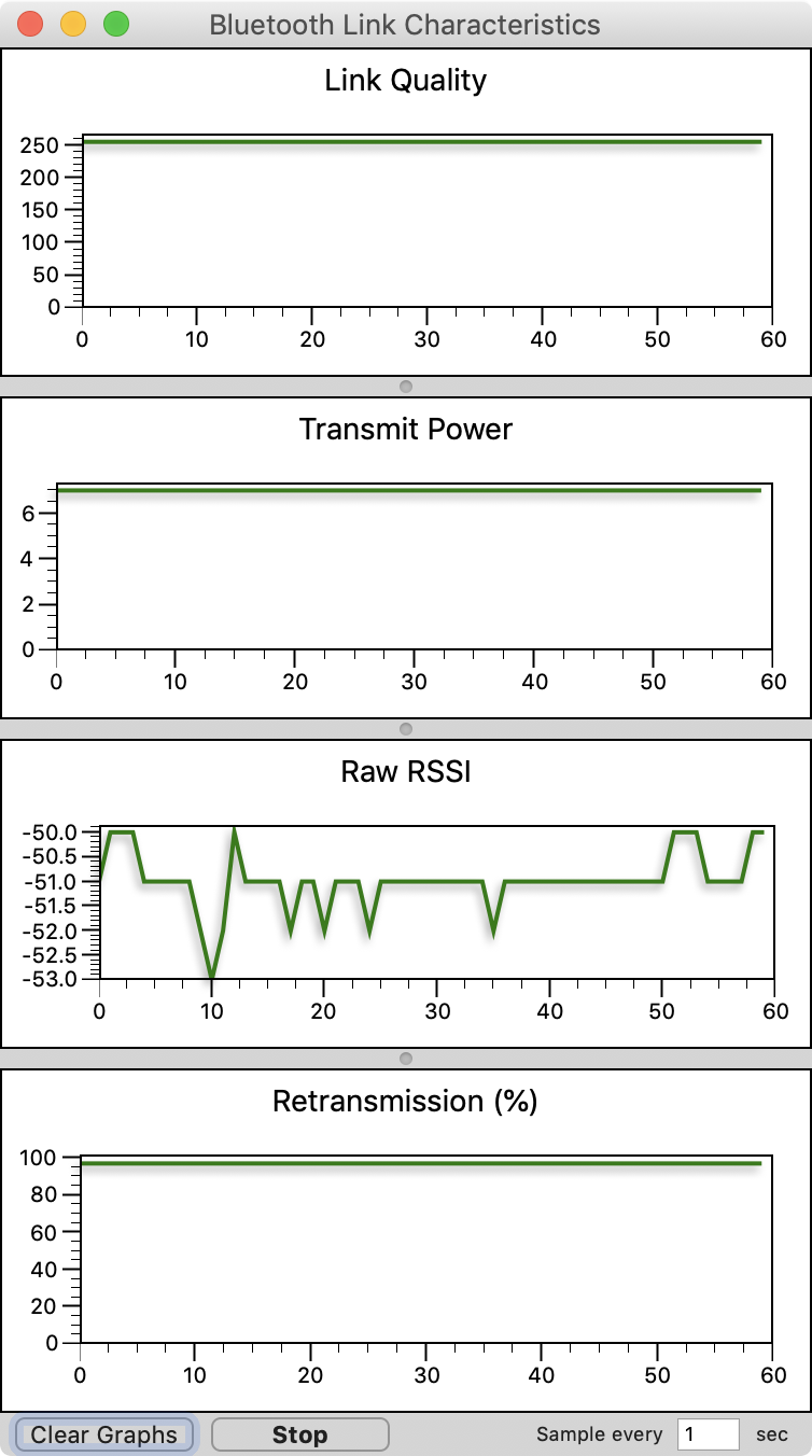

1170Mbps wifi connection. Airdrop usually around 15MB/s (vary between 10-20MB/s)
Magic Mouse connection stay at 100% Link Quality
Reactions: Upgrader

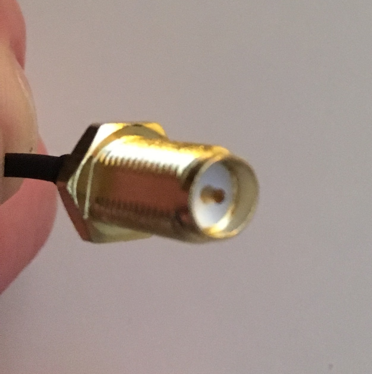

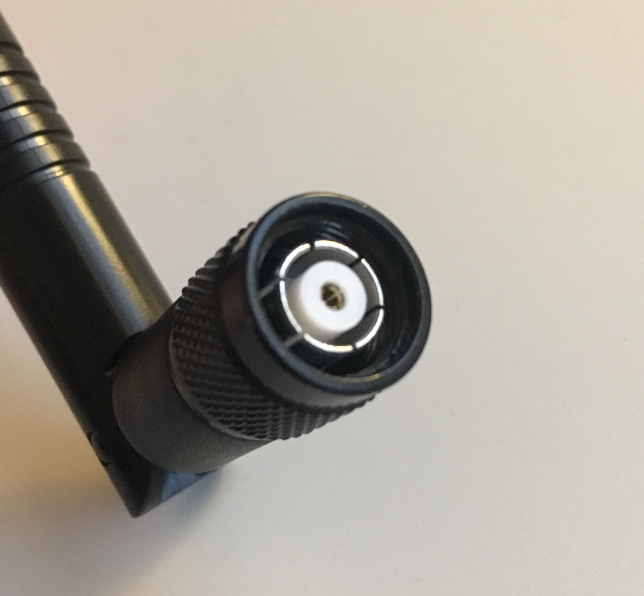

So I finally got the parts delivered to upgrade my BT.
- U.FL Mini PCI to RP-SMA cable
- and an antenna by Alfa - an ARS-N19 TNC 9dbi WiFi booster RP TNC screw on connection.
The two connections aren't compatible.
Can anyone recommend a good antenna that will connect to my RP-SMA cable? Alternately, a suitable cable for my antenna. I'm searching high and low here and nothing appears to be compatible.
Thanks.
Thanks.
There should be plenty of SMA antenna on the net. I just did a quick search on amazon, lots of options.
e.g. This one
https://www.amazon.com/HUACAM-2-4GH...f_rd_t=40701&refRID=4H7TBBPPEKDBPG6YH010&th=1
Reactions: Upgrader
