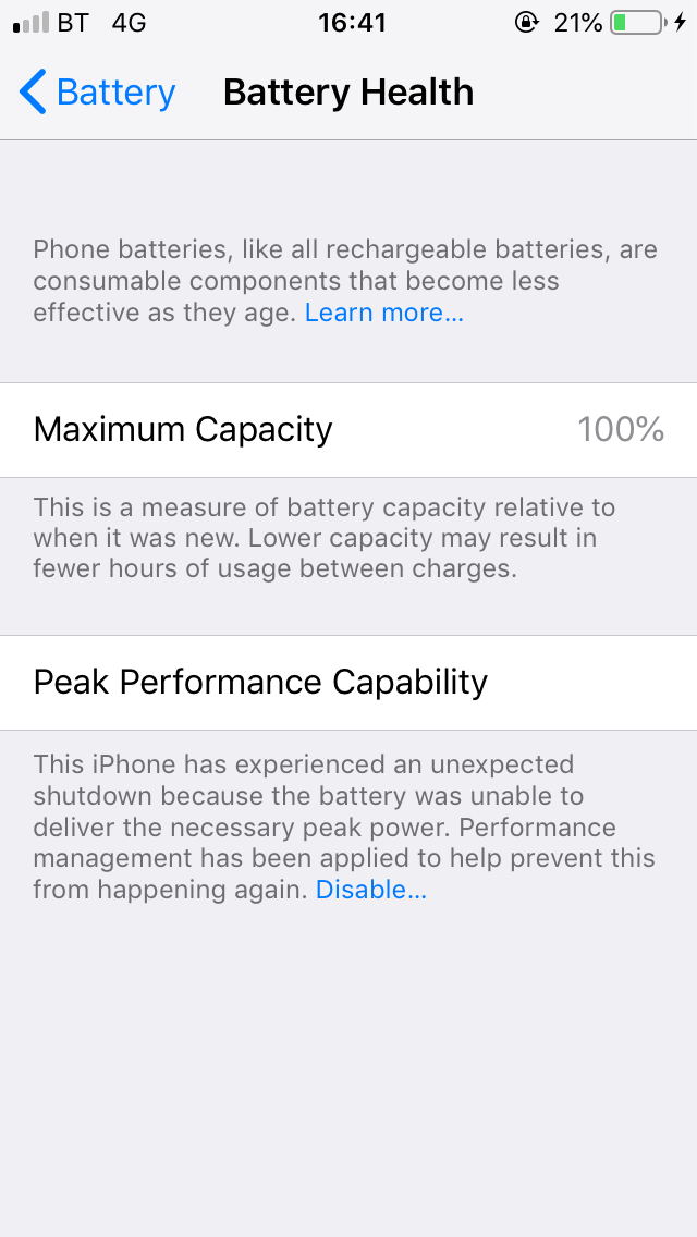

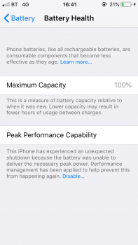

I’ve had nothing but trouble with the SE battery since updating to iOS 12 last week. Irregular % countdowns, different battery levels if you turn off and power on again, phone turns off at 5% and today experienced an unexpected shutdown due to peak power levels. The phone is only 10 months old and reporting 100% battery health.

My SE has had plenty of time to settle down, updated it the minute iOS 12 was released. Is the battery just not up to the job for iOS 12 even at 100% capacity?
My iPhone 6 Plus at 94% capacity easily lasts 2 days with normal usage and my iPad 2017 can last all week! Both on iOS 12.
Just seems the iOS 12/SE combination has issues for some.
