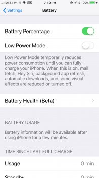

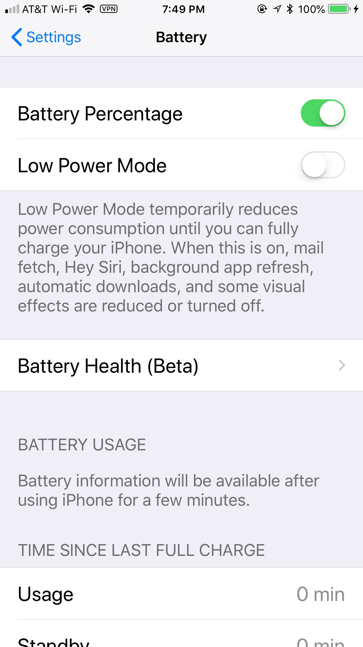

Yes, I have pretty much noticed this. On AT&T while at my house, I can not make a call or text anyone unless I use WiFi calling. You can see in my screen cap that I have only one bar of signal.
