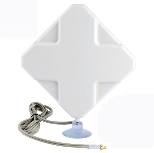

Yes, I have a Huawei 4G MiFI portable router which also has a connection for an external antenna that you can attach to a window. Think that you would need to see what Huawei offers in your region as the MiFi varies and the type of connection single or dual.
Similar to this
It wont work miracles, equally I found it made a difference in some areas of poor reception.
As for the WiFi move closer to the router, invest and get a MESH type system or just use a cable. If the connection to the router itself is poor, you can only speak to the provider or try to replace them.
