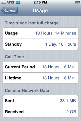

Does having WIFI and Fetch on kill your battery? I know having WIFI and PUSH on does. I have had WIFI on all day connected to my work network and Fetch set to hourly. My battery looks to be about 25-30%. It seems very low for how little I've been using it.
3G: Off all the time
PUSH: Off all the time
WIFI: On all the time
FETCH: Hourly
Brightness: 25%
Autobrightness: On all the time.
Bluetooth: On for about an hour
Location Services: Off all the time
I've sent maybe 20 test messages today and maybe 50 IM's over AIM. A little gaming and probably an hours worth of web surfing.
I'm starting to think my battery is defective. What do you think?
Thanks

I get similar usage from my iPhone at work. Push and WiFi are both on, barely use the iPhone and still by the end of the work day I'm about 1/2 down on the battery. Try shutting your WiFi off tomorrow just as a test to see how your battery holds up then.
Here are my changes for today marked in RED.
WIFI: Off all the time
FETCH: Manual
Brightness: 25%
Autobrightness: Off all the time
Sent about 20 test messages and 30 IMs over AIM. Talked for a little over 30min on bluetooth and did a little bit of web surfing.
Here are my results so far:

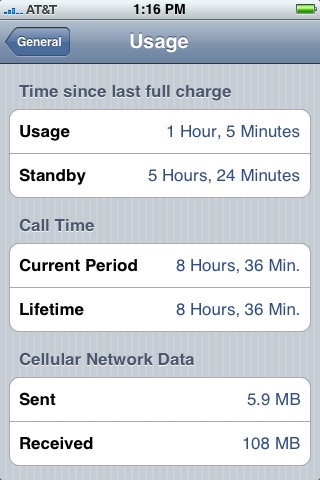

Roughly the same usage and time even added some 3G fun. Different day. Different settings. Different results. Find my settings on post #8.
Conclusion: WIFI eats up your battery if you leave it connected all day. I knew this, but I didn't know it ate up that much.
Left image is the original one in the original post. Right image is today's test.
