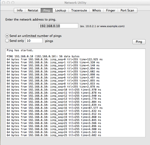

MBA 2010:

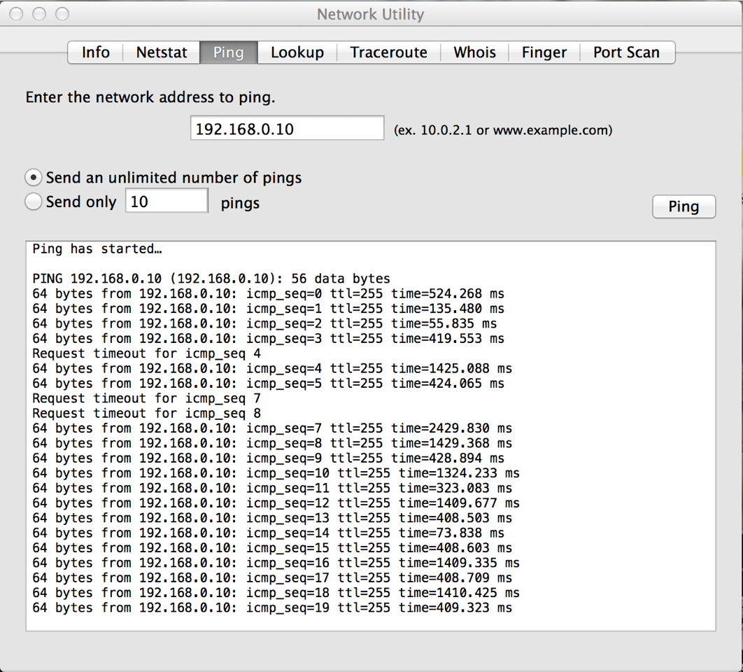

and here new rMBP 2013:
I have ping the same from my second rMBP - same problem as with my wife's. 🙁
Just wonder if its hardware or software ...

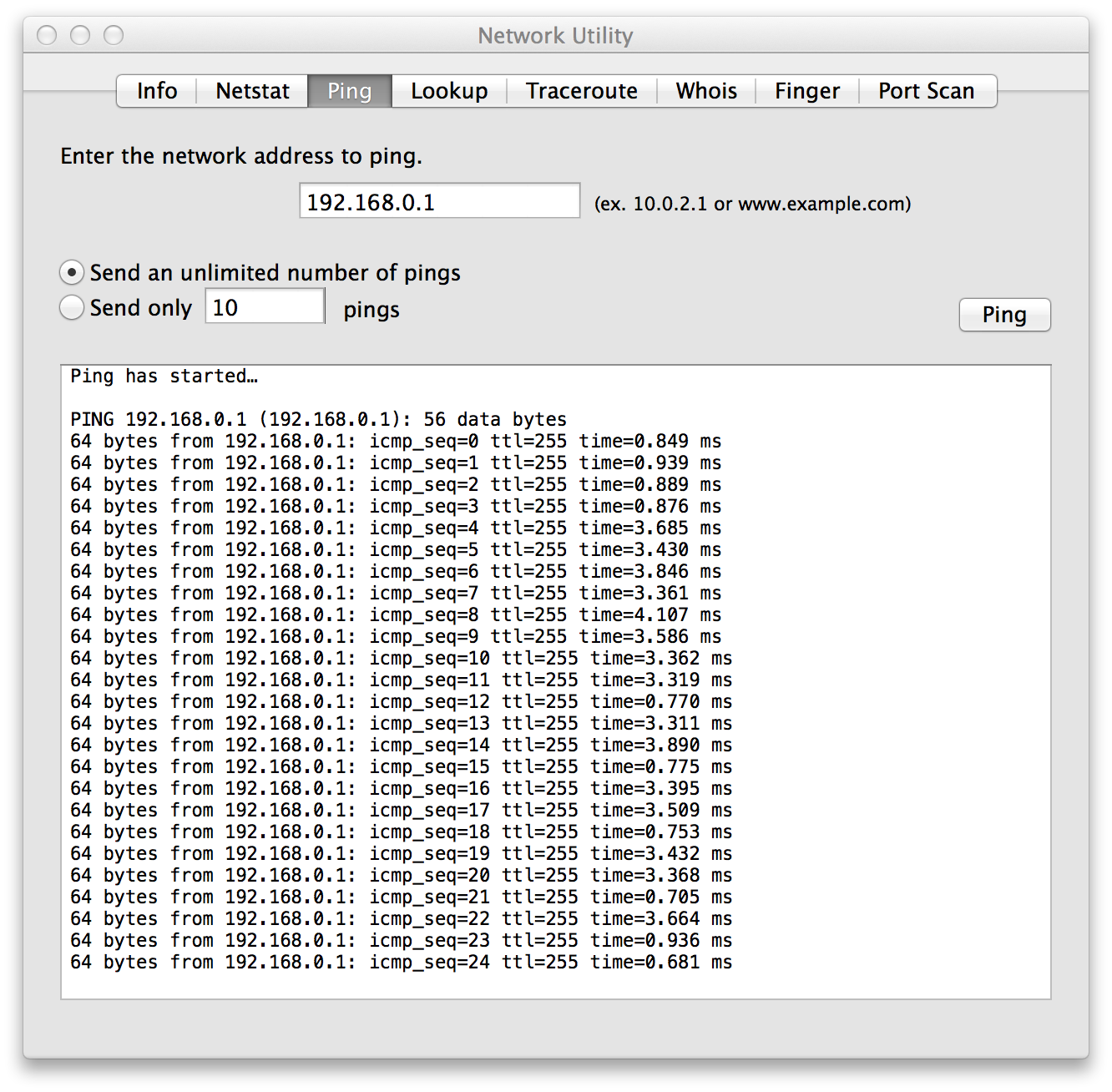

I have the early 2013 rMBP 15" and TC of 4th gen, and I get following results (5GHz 802.11n PHY):

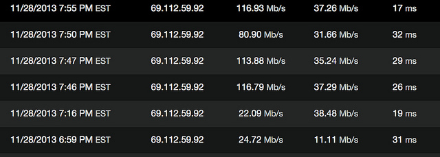

i'm having similar wifi issues.
typically when pinging a particular server on my 101/35 connection, i get 10ms ping and 118/37 speeds. i get these speeds consistently on windows machines in the house.
the new mbpr 15 i bought has both horrible ping and speeds. the ping is consistently higher at ~30ms to that same server at all times of the day, and speeds right now for example, while perfectly normal on my old thinkpad, are a fifth of what i get on the thinkpad. anywhere from 20/11 to 24/35.
its clearly not an isp or router issue(net gear r7000), so i await a fix from apple as this is unacceptable.
edit:
did some further testing and completely forgot to mention one big factor.
pings are poor on both 2.4 and 5ghz. speeds are fine on 2.4 but poor on 5ghz.
everything over 100Mbps shown here is at 2.4ghz and anything under, including the 80Mbps down, are at 5ghz.

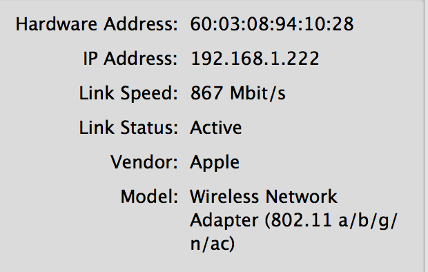

Is this the IP that I should put into Ping?
If so the results that I'm getting are:-
