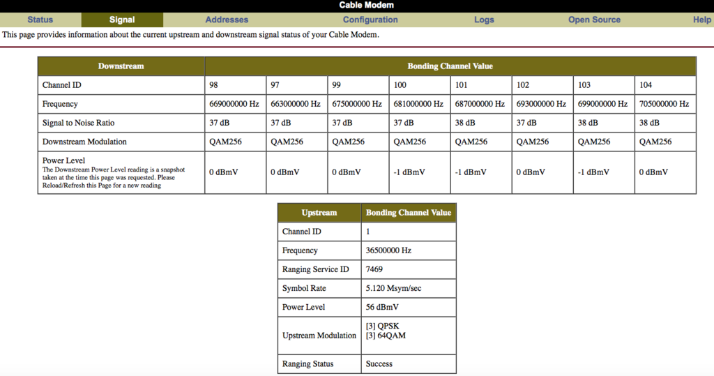

Going through the router -

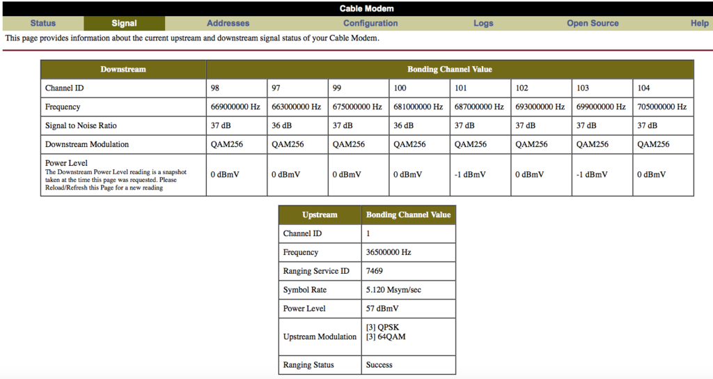

And direct from the modem -

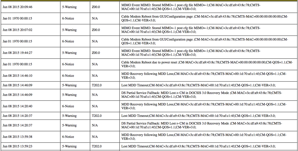

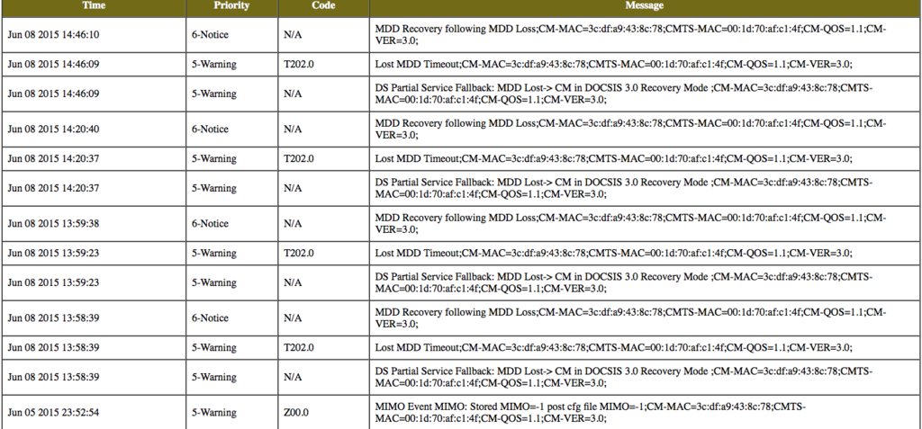

Your downstream signal levels are good, but that upstream level 56 dBmV is way high and that is likely the problem. That upstream level should be under +49. What happens when that level is so high is the modem will try to reconnect at lower speeds and that causes the log entries and slow speeds you are seeing.
I would have the cable co. come out and check your coax cables and connections out the the street and see if they can fix that upstream signal issue you have.
If you have any splitters between the cable modem and the connection to the house, try removing those.

The first set of images were going through the router and the second set was connected directly to the modem. I contacted Motorola. The person I spoke to said the same thing that you did. The upstream level is to high. He also asked if I have a splitter. I don't have one. I called Comcast after that. The person there wasn't to helpful. Didn't seem to have the knowledge that you and the gentleman from Motorola have and though everything was good because my computer is seeing the speeds that it should. I had to remind him that the issue is with my WiFi. After that he said there must be an issue with the router (Airport Extreme). I've used my iPad to do a number of tests in the last hour. Results are in the 42-51 Mbps range. Results last night were from 76-120.
