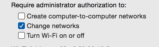

In addition to Android300zx's excellent advice, you can also tick the checkbox which requires authentication from the admin in order to change networks.
Where is that checkbox? And I presume that if you check it when on the current network a change can't take place unless you do so administratively?

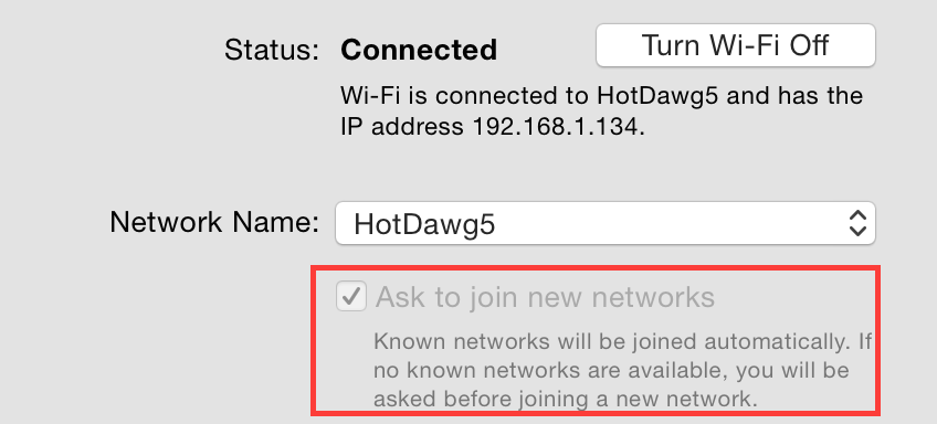

Here:
This one under System Preferences -> Network -> Advanced

There seems to be several fixes that have varying degrees of success. Here's one I ran across last night I hadn't seen before.
