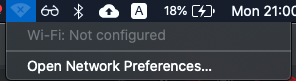

So, i tried and when i making a new location, still the wifi symbol says that the wifi not configured.
The grayed-out wifi icon with an 'X' can indicate either that wifi has been disabled, or that the OS can't find wifi hardware (hardware failure).
Run Wireless Diagnostics: Hold the Option key and click on the wifi icon, and choose Wireless Diagnostics from the menu. See what it tells you.
You can also open System Report > Network > Wi-Fi. Look for Interfaces - it should detect a card type (probably AirPort Extreme). If not - hardware.
You could also boot your Mac into Recovery Mode. https://support.apple.com/HT201314 and check the Wi-Fi icon again. If Wi-Fi works, then there's something about your normal wifi configuration that needs to be changed. If you see the same icon as previously, you may have a hardware problem.
Open Network Preferences. Does Wi-Fi appear in the left-hand column?
If not, click the '+' button at the bottom of the lefthand column and choose "Wi-Fi" from the Interface drop-down list.
If that wasn't the issue, refer again to my suggestion to run Wireless Diagnostics in my previous post.
