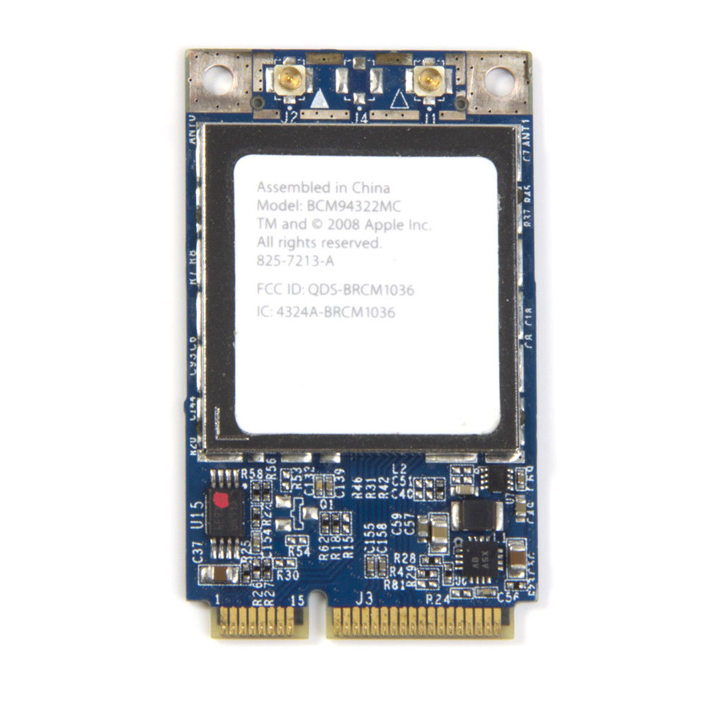

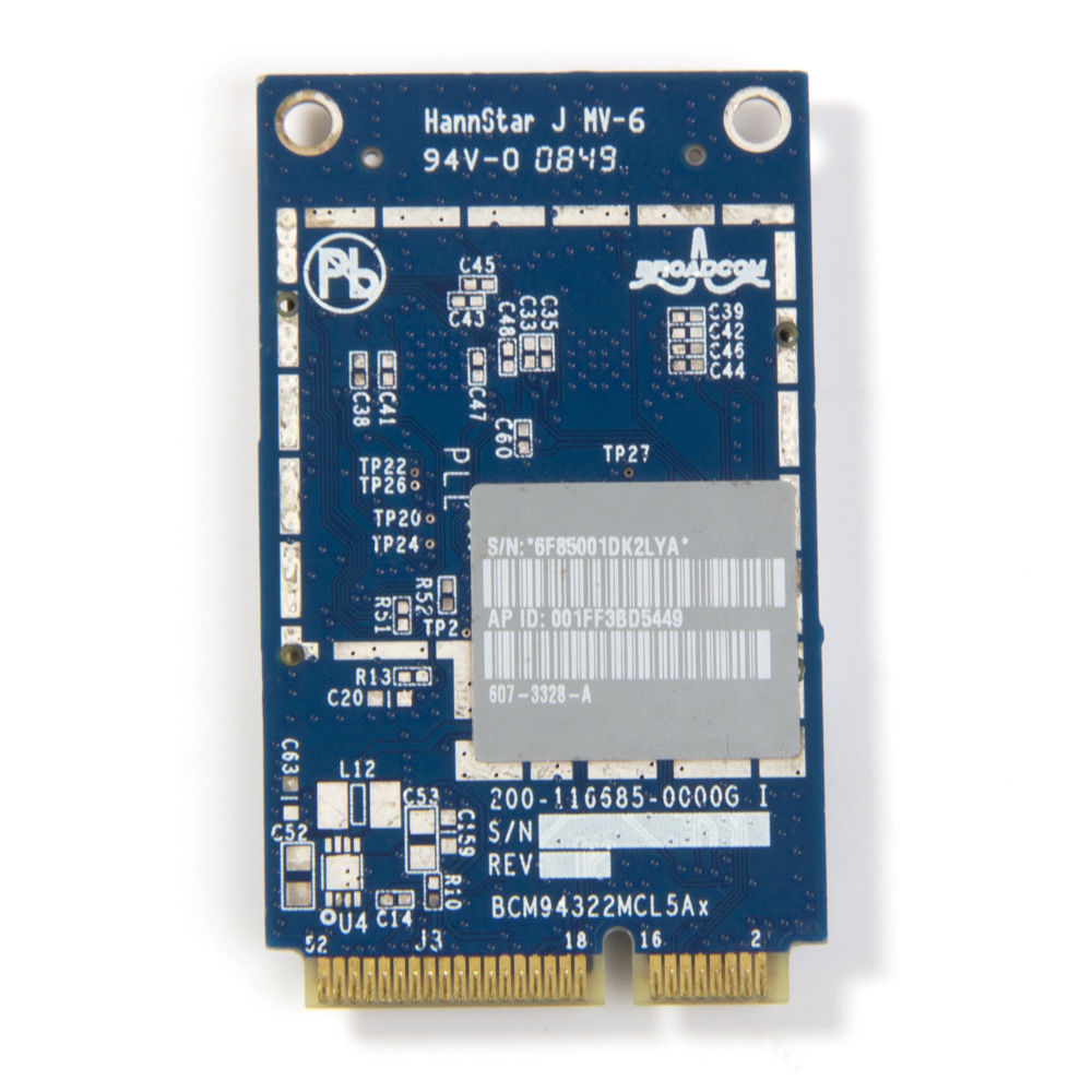

Nice! Just a warning if you bought a 3rd party one, sometimes they just support 2.4GHz. A easy way to recognise the original is the white label with Apple © at front and the gray label with serials and SKU on the back, just like this:
