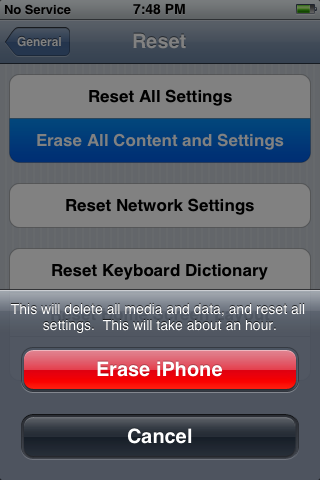

When in doubt, Sync and Wipe it all.
I went this horrible route with my newer 3GS ios4 because of the wiFi issue. Wiped everything. Big mistake. Didn't fix the problem either.
It was a last resort, because nothing else fixed the wifi problem I'm having.
