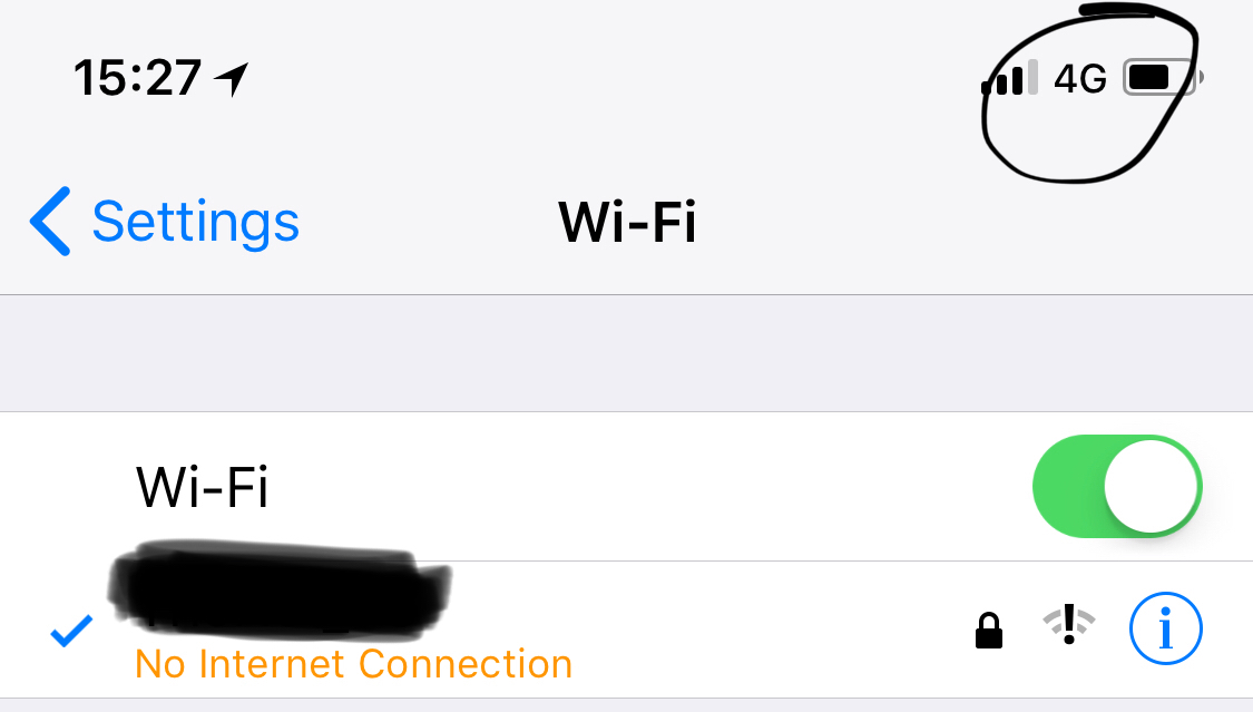

I only tried wifi in the dashcam’s wifi. As far as I could tell, other wifi wasn’t affected. I noticed that after the settings change, the wifi sign had an exclamation in it. Is that supposed to happen?

Yes...you should get an exclamation mark through the WiFi symbol and a messages underneath the SSID. You’ll also show a cellular symbol instead of WiFi in the status bar as you’re no longer trying to access the internet through WiFi.
Once it’s setup like that, you should be able to access the camera over WiFi, and the internet over cellular.

Yes, it looks like that. I tried it multiple times with the same result. I will try with my OBD2 at some point, but I really wanted this to work with the dashcam as it's always connected. Let me know if you have any other ideas. Until then, I'll crawl into my corner and be bummed.
