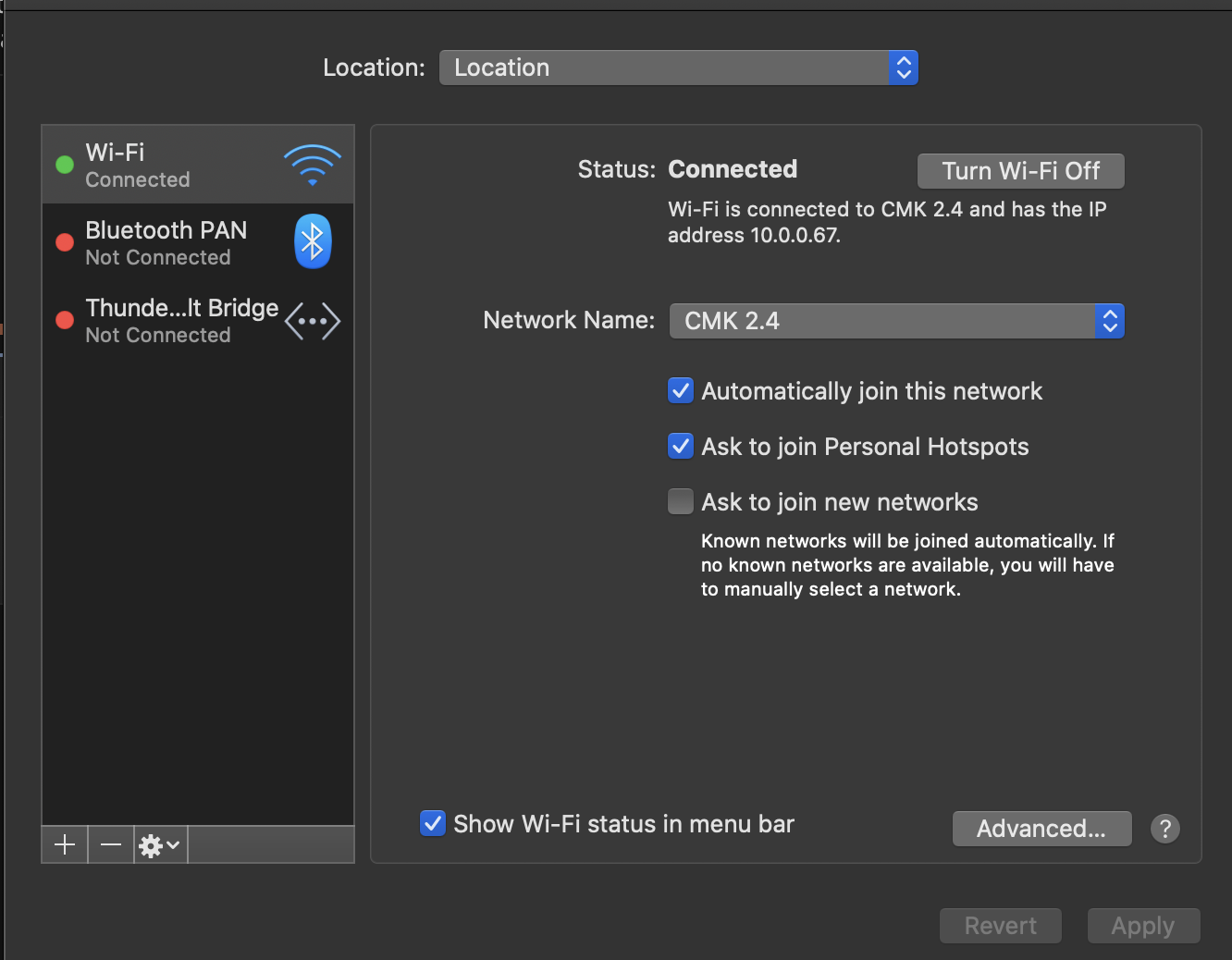

Ok in affected Mac I want you open System Preferences->Network Pane and highlight you’re Airport tab. The in Airport tab change the Login tab change the Automatic Location and create a custom named Location! Don’t worry it will act the same!
Okay, is this what you mean?
Still no improvement in Tx Rate, which is around 65.
