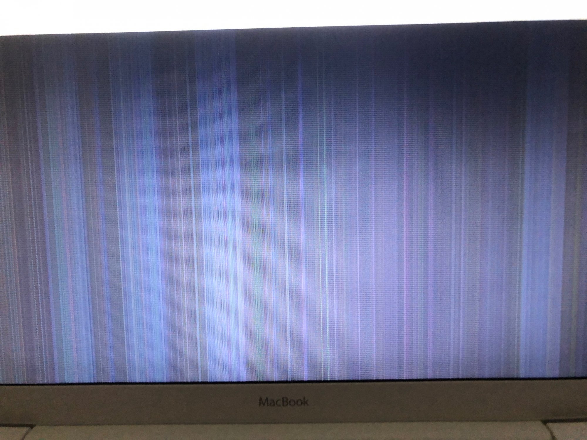

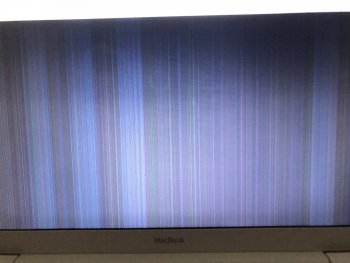

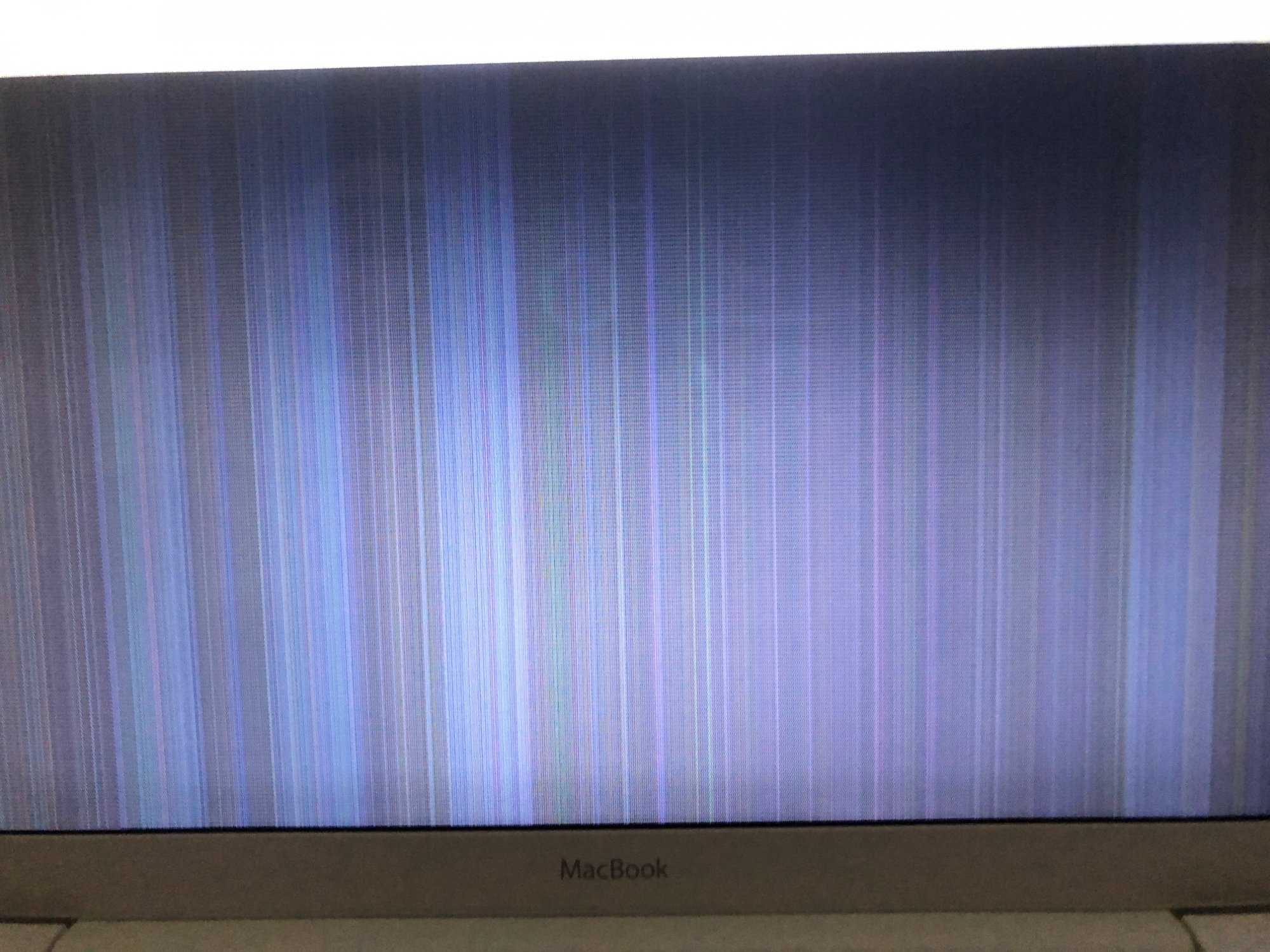

New here and new to Macbook. My grandson has a 2010 Macbook Pro that has some problems. As grandpa is the family geek he gave it to me to fix. The hard drive clearly failed so I replaced it with a new one. I have tried to use internet restore several times without success. On two occasions the globe came up and requested the wifi password. Before I could enter it the image just faded to white. Most of the time it boots to a colored screen (see pic) then slowly turns pure white. I know its old but it's all he's got so I would like to get it up for him.Thanks in advance for any ideas.
If you saw the grey spinning globe, that model has Internet recovery. What you are describing with that screen sounds like either a bad LCD screen or a failed graphics chip, neither is easily fixed.
Is this a 13" or a 15" MBP (latter has discrete GPU, I believe).
If it's a 15" with a discrete GPU, and the GPU is failing, it -might- be possible to bypass it and run from the "integrated" graphics, I think...
