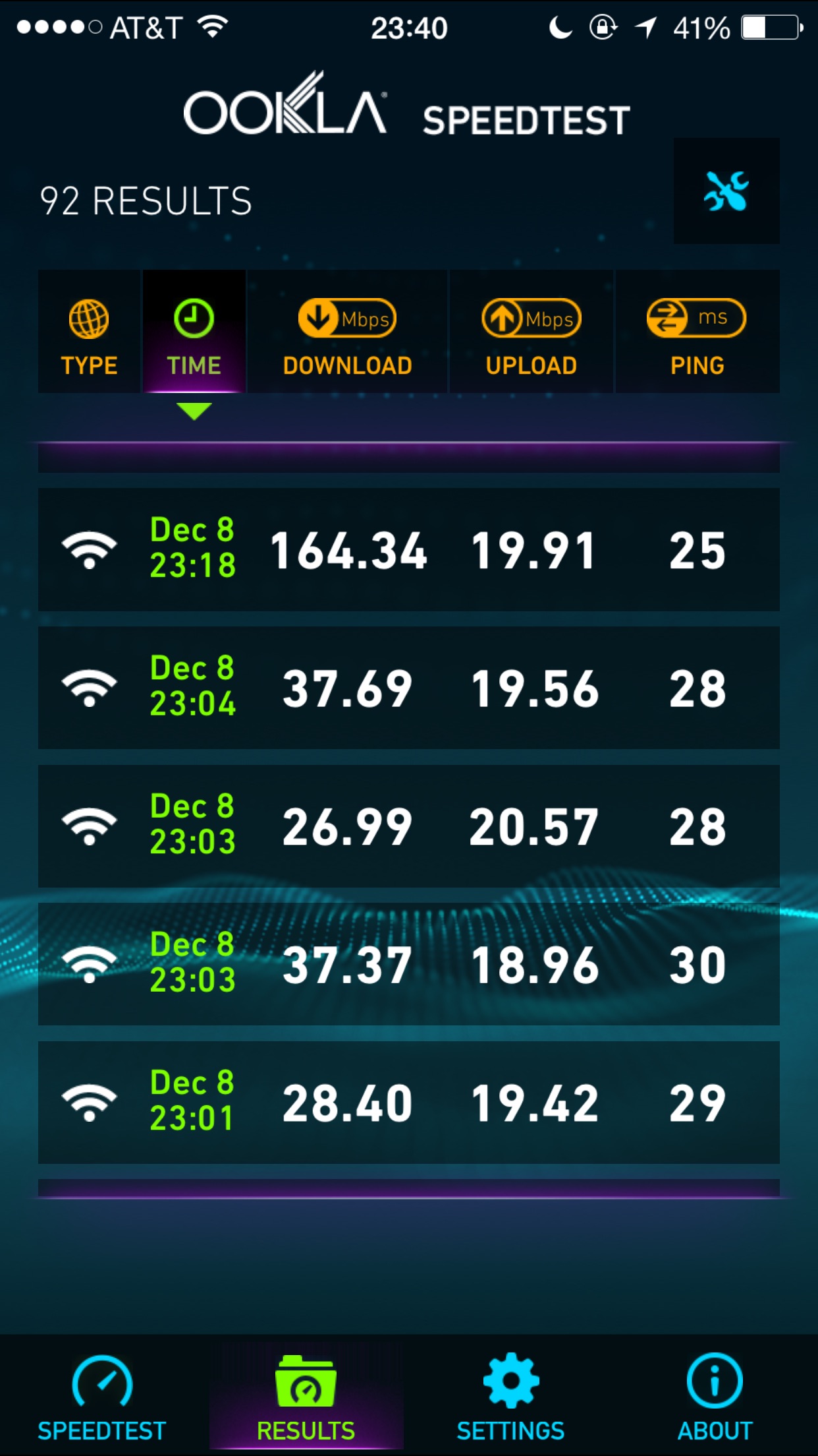

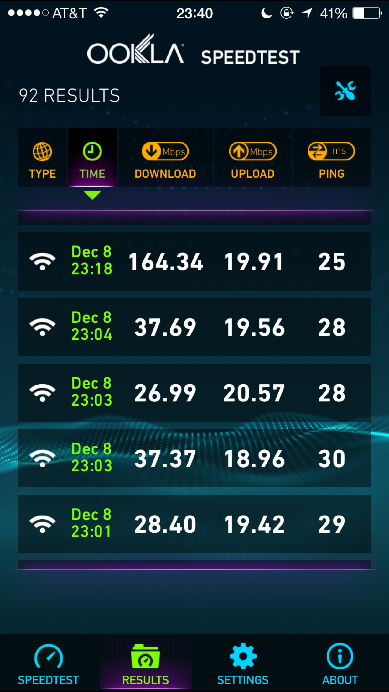

I restored my iPhone today and upgraded to iOS 8.1.1. I set it up as a new iPhone just to test it out without anything being added to it. Then I downloaded the speedtest.net app and tried my luck. I was able to reach about 150Mbps, but only a couple of times. After that, it was fluxiating between 30Mbps and above. Nothing over 150Mbps though. Although I had Bluetooth on and my cellular data on, I want to try it without either one of them on and see if I get different results. I'm away from home right now, but I'll report back when I get there.
I just got home and did a few tests. Even with the cellular data off and Bluetooth off as well, it doesn't make much of a difference. The speeds are very erratic and unstable. I agree with some of you here that it may be software related, as my MBP reaches speeds of over 300Mbps. With the current network technology that the iPhone 6/Plus has, reaching 300Mbps shouldn't be a problem at all.
