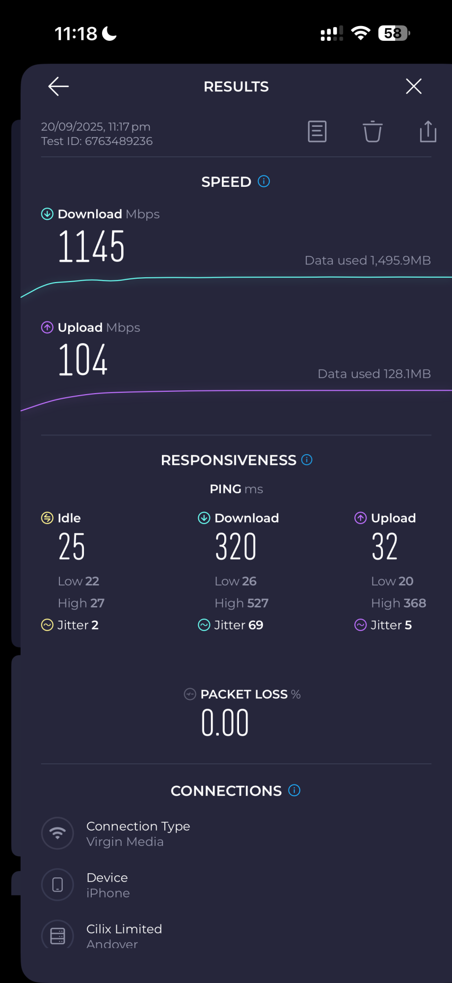

Wi-Fi speeds on the 17 PM are the same as at the 16 PM for me. My internet speed maxes out at 1200Mbps down, 110Mbps up, and I'm definitely getting that without issues.
This was on a Netgear RS700 router on 6GHz, same speeds on 5GHz. I do find the 17 PM does a better job at maxing out my upload speeds quickly; 16 PM struggled a bit at times and usually took a little while to get there, but my 15 PM was just as quick at maxing out my upload speed as the 17 PM.
