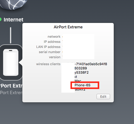

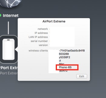

As mentioned above the behavior could be normal its just odd you are just now experiencing it. I notice my iPhone seems to stay connected to wifi, HOWEVER I'm using Wifi calling. Currently my iPhone has been unplugged and locked for about an hour.

When not plugged in and with mobile data enabled the phone typically disconnects from WiFi, as was mentioned by others. If plugged in or if there's no mobile data (or WiFi isn't in use for other reasons like WiFi calling let's say) then it would typically stay connected.
