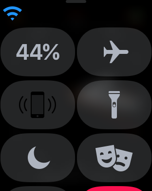

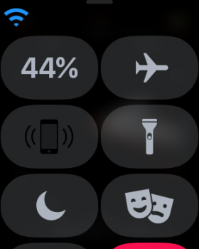

Wifi symbol WORKED.
NOTE: This only happens when the iPhone is switched off (for both the iPhone 7 & 6S). This does NOT happen when the Apple Watch is put in Airplane mode.

Powered the iPhone 7 off and the WiFi symbol re-apperared !!!!
