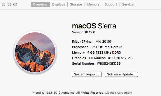

Hi I believe this problem started happening after macOS Sierra 10.12.6 updated on it's own but I'm not sure. What is happening is my internet connection works great and speedy for approximately an hour then slows down so much it won't even load a page. I then shut down my mac, start it back up, and it's back to working normally for about 45 minutes then the same slow down again. It is an older computer iMac (Mid 2010).
