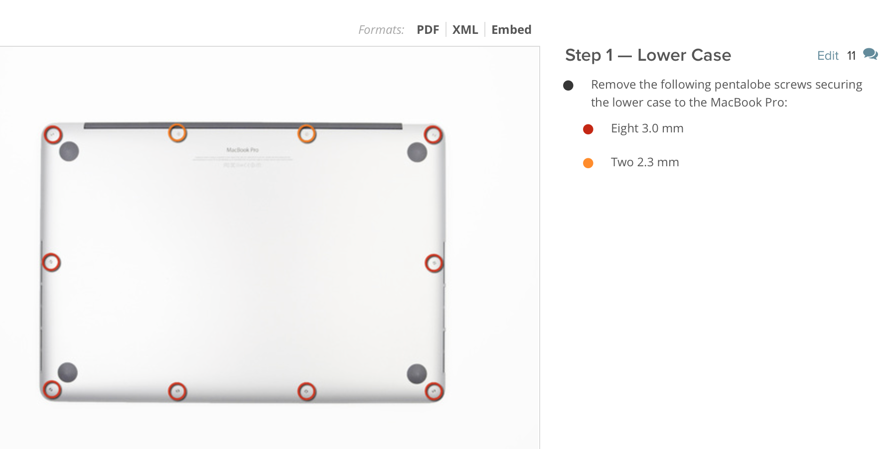

When I took the cover off my 2013 rMBP the screws were two different sizes (different lengths).
The way most small fasteners like these are manufactured leaves an inherently noticeable amount of size variation, which I guess is what you're seeing when you bring a relatively precisely-sized tool like the Wiha to the process. 😱
I am 99% all mine were same length (late 2013 rMBP), but you have left me with a niggle of a doubt. If different lengths explained why one would not go flush initially then the difference in lengths is extremely small, like maybe a quarter of a mm, which is enough to not feel flush but a small difference to observe. At least by swapping them around I have ended up OK since all screws were flush under light torque.
My 2011 MBPs had three (Phillips) screws which were much longer than the others.
I can't say that all of the late 2013s are the same because there's the possibility of inline changes during production but four of the screws in mine were shorter than the others. It was almost impossible to see but easy to feel with your fingers when they were screwed in!
I think that the screws along the front edge (keyboard) are shorter length than the ones along the rear edge of the computer (at least on the models I have opened). I recall seeing that mentioned on a disassembly graphic in either a users manual or service manual for one of the computers as well.
I always keep track of each removed screw so that it gets replaced in the exact same location.
I think that the screws along the front edge (keyboard) are shorter length than the ones along the rear edge of the computer.
Absolutely right!
Diagram (courtesy iFixit) shows why I had the problem refitting the screws....
My swapping about to get them all flush was simply to get the short ones in the right place.
Another "Never Assume" (that the screws are the same because just they look the same)

Absolutely right!
Good find, I recalled it being four, not two, but go with iFIxit for sure.

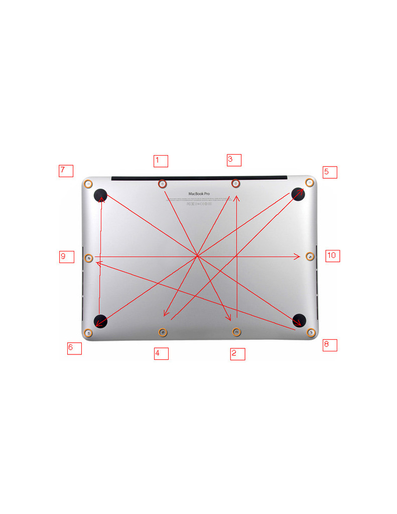

I don't know if iFIxit mentions it in the reassembly section, but how you tighten these is actually important. They should all be reattached just barely snug, and then tightened in a cross-star pattern working from the center out.
