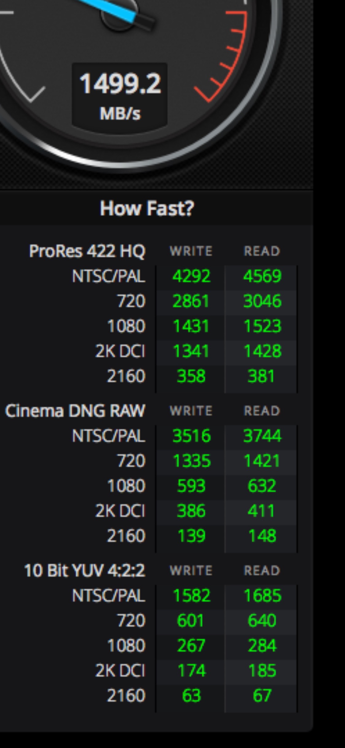

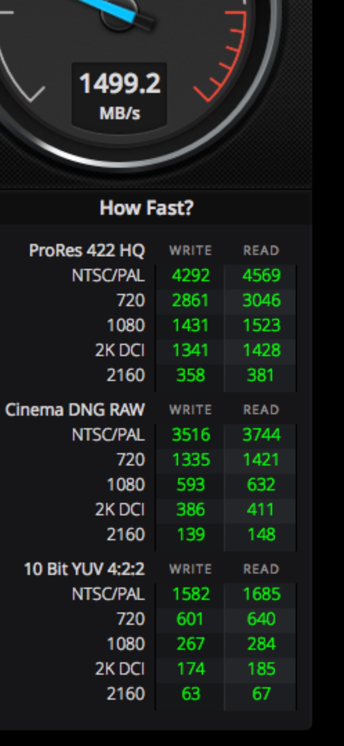

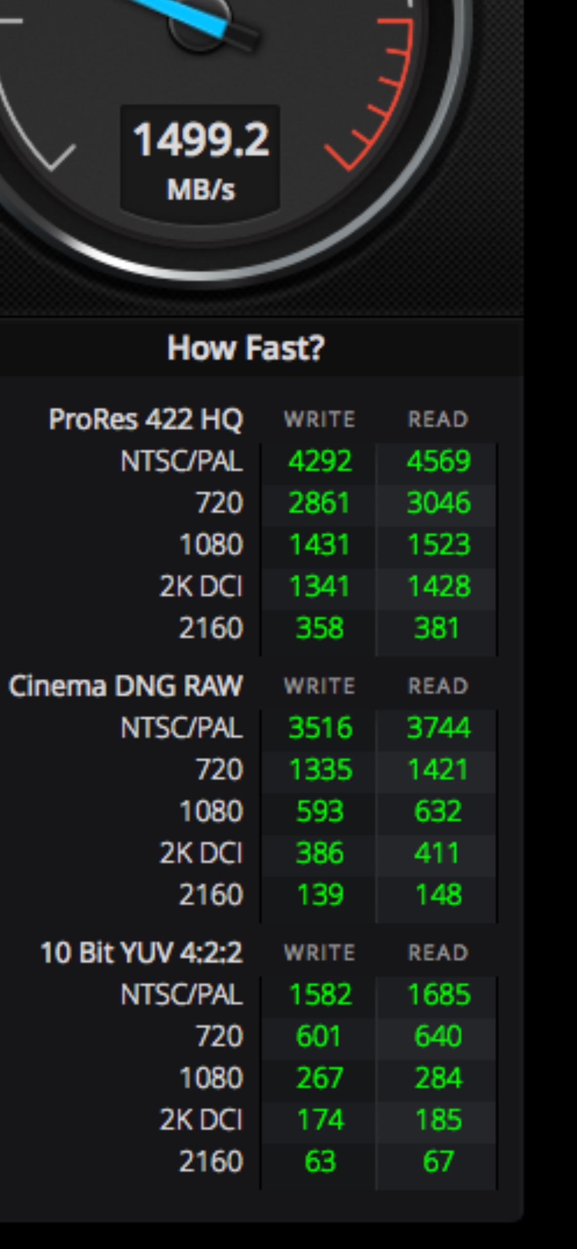

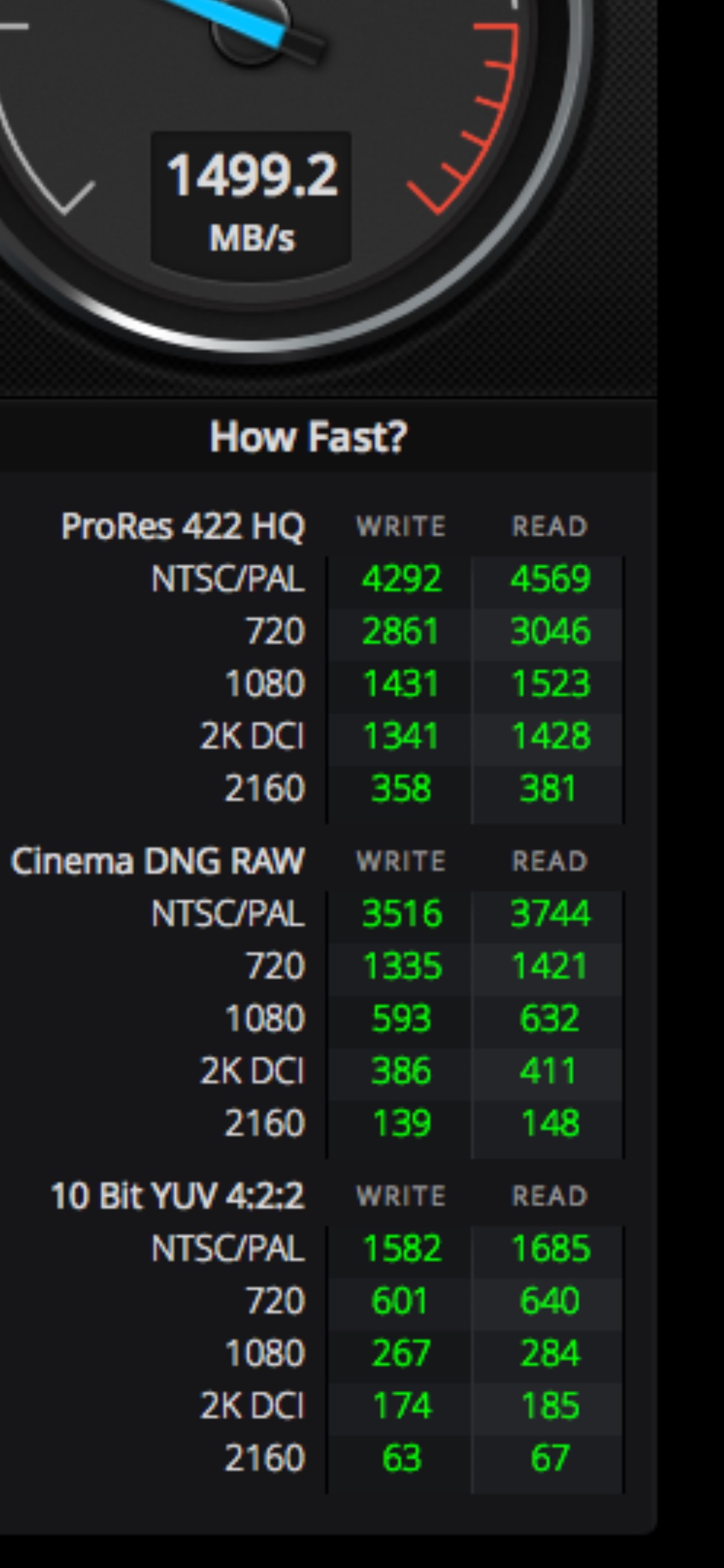

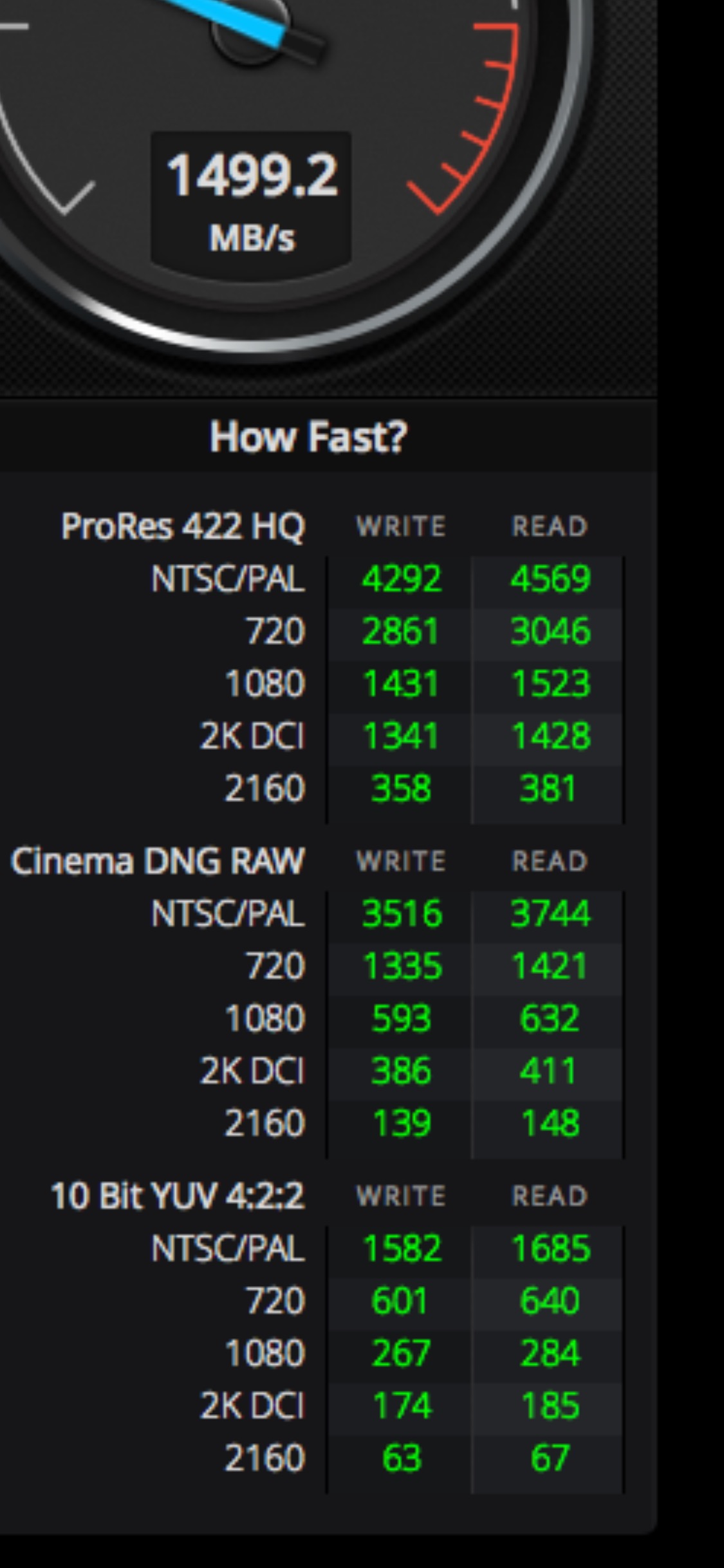

Borrowing firmware from the MP 6.1 the MP 4.1, 5.1 can boot and update normally using PCIe NVMe. 1.5 GB/s!!! ;-)
What are you talking about? Borrowing DXE or firmware?
And that post was about boot re-direction, not firmware mod. 5,1 can boot from NVMe now with the official firmware 140.0.0.0.0, no need to borrow anything. And of course can perform OS update as well.
