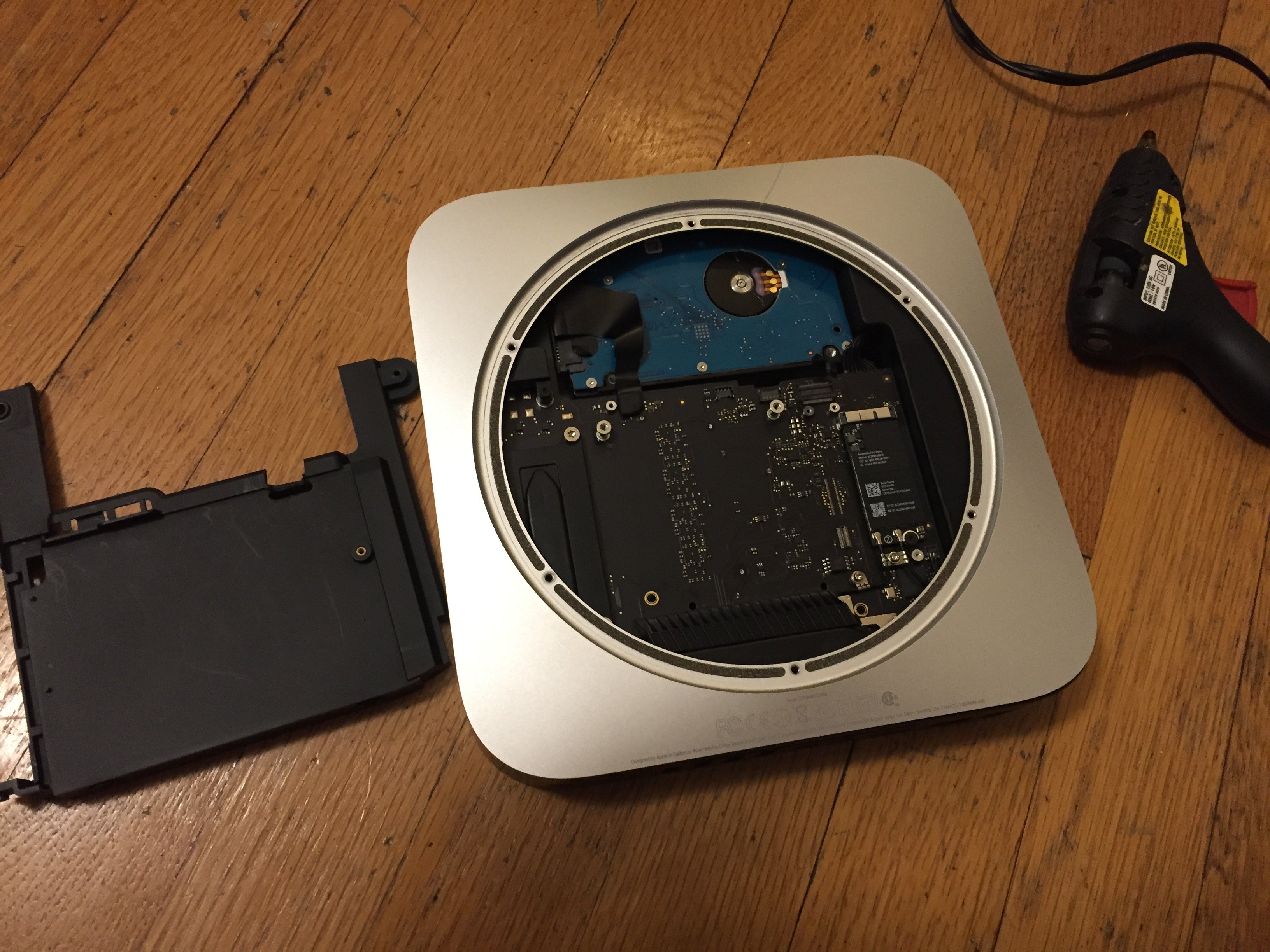

Finally committed to this project and got a well priced 5TB Barracuda from Adorama. The 2014 model's harddrive caddy is different that the 2012's. I wasn't able to make it fit back in at all, even after modifying it a bit. The drive was just too tall and it lifted the caddy up higher than it was meant to be. What was worse the IR sensor and power light are attached to the caddy and didn't line up with the chassis holes. So I ditched the caddy altogether. I used a tiny square of thick double sided tape to stick the IR/light to the chasis. I then hot glued the drive to the roof of the mini. It's a great solution because the dabs of glue act as a riser so the "don't block this hole" hole is not blocked, the rubbery nature of the glue reduces vibrations, and it's easy to remove. I know because I had to reorient the drive once and pried it off and removed the dabs easily. Make sure the drive is situated all the way in touching the inner face of the mini or the mother board won't fit back in. The drive is working great so far.
I always like to end these successful projects with thanks to those who helped. And for those who like to say "why bother with this?" I like to ask, why bother answering the thread? Tech forums are for hacking things to do what you want. I wanted a large internal drive for many reasons that I don't feel I need to share. It's pointless to say "just don't bother". And for those who also want to do this, it's a perfectly possible 20 minute project. Hope this will help you get it done.

I’m interested in completing a similar setup and was wondering if you could provide the part info for the 2012 Mac mini tray you replaced in your 2014 Mac mini. Here’s a listing of parts I located of the Mac mini unibody A1347 - Late 2012 https://beetstech.com/store/apple-parts/mac-mini-unibody-a1347-late-2012. I am hoping that it might be possible to simply purchase the 2012 or 2010 Mac mini tray as a part. Rather than having to locate and salvage one from a faulty 2010 or 2012 Mac mini.
