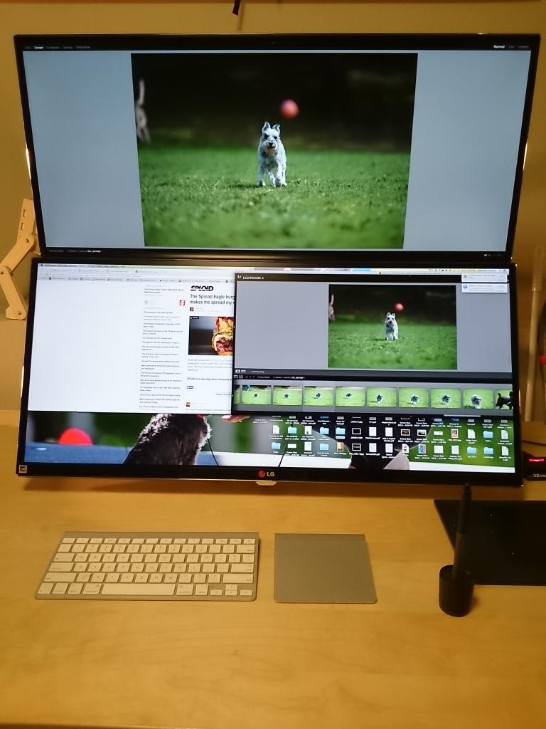

You're going to get two kinds of replies to this question:
1) You must wait for Apple's 4k/120hz/IPS/curved/magical unicorn display. No exceptions.
2) Get the LG 34um95 and be happy. In fact, get two and be twice as happy!
