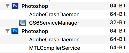

I know in CS6 Photoshop had an update that made it a 64 bit app.
From Photoshop CS6 Release Notes:
32-bit and 64-bit versions
On Windows, both Adobe Photoshop CS6 and Adobe Photoshop CS6 Extended have the option to run natively in either 32-bit or 64-bit editions. On Macintosh, only a 64-bit edition is available.
There were some updates, but not especially related to 64-bit:
The most current update for Photoshop CS6 is 13.0.6 (macOS) | 13.0.1.3 (Windows) for perpetual/boxed licensed product and 13.1.2 (macOS/Windows) for Creative Cloud members
These were the changes. As an Adobe CC subscriber, a perpetual licensed version could get updated to 13.1.2 and was thereby changed to a subscription version.

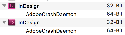

I don't think Illustrator was updated to 64 bit and I know Indesign was not updated to 64 bit till the next release Adobe CS.
Although I guess there are 32-bit code fragments inside every CS5 and CS6 app, just Photoshop CS5 is showing up completely as 64-bit in Activity Monitor. The ServiceManager can removed by renaming it to .bak.
