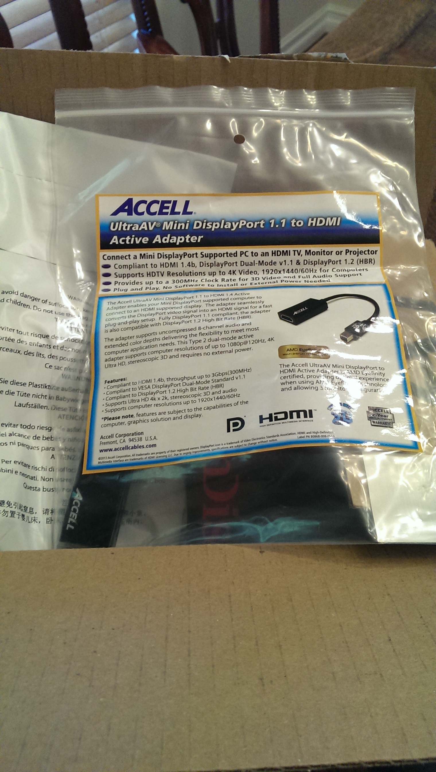

Just ordered the exact part you recommended for Amazon one day delivery - shall have it tomorrow! Looking forward to being able to use my rMBP on my LG 84LM9600 - 84 inches of UHD!
Got it! Amazon next day, ordered last night at midnight, nine hours later, boom!
Yes just got it as well. BUT.
Ordered the Accell adapter from amazon. Overnighted and got it about an hour ago. But can't get it to work at 30hz. Same setup rMBP, SEIKI 50". Had this working with the Moshi adapter at 14hz. What's the catch, do i need the patch?

Your photo looks like the exact same adapter I have. I didn't even have to add a custom resolution - plugged it in and the 30Hz option showed up (along side the 19Hz I had previously added). What resolution options are you getting?
It could be the EDID on the LG isn't giving out the right data. If you want, I'll get the exact settings for a custom resolution off whats being used with my SE39UY04, but its on my work machine so can't do that until tomorrow.
ariaaria - you got the active adapter, not the passive adapter, right? (see my earlier post for where I screwed that up). Do you still get 14Hz as an option?
Sorry the both of you are having problems. It was very smooth on my side 🙁 With the rMBP, you could use Tom's patch. It just didn't work on either my iMac or my mac mini, so I had to go the adapter route.

Yes its the active, so the package label states. The package is exactly the same looking as mrkennethtong.
Yes the 14hz is still working but only with SwitchResX. Without it nothing but 1080p. I'm sure its just a matter of configuration. SwitchResX is a bit buggy for me. I can't seem to get a custom setting to become active. The 14hz setting was kinda lucky after spending hours on it.
