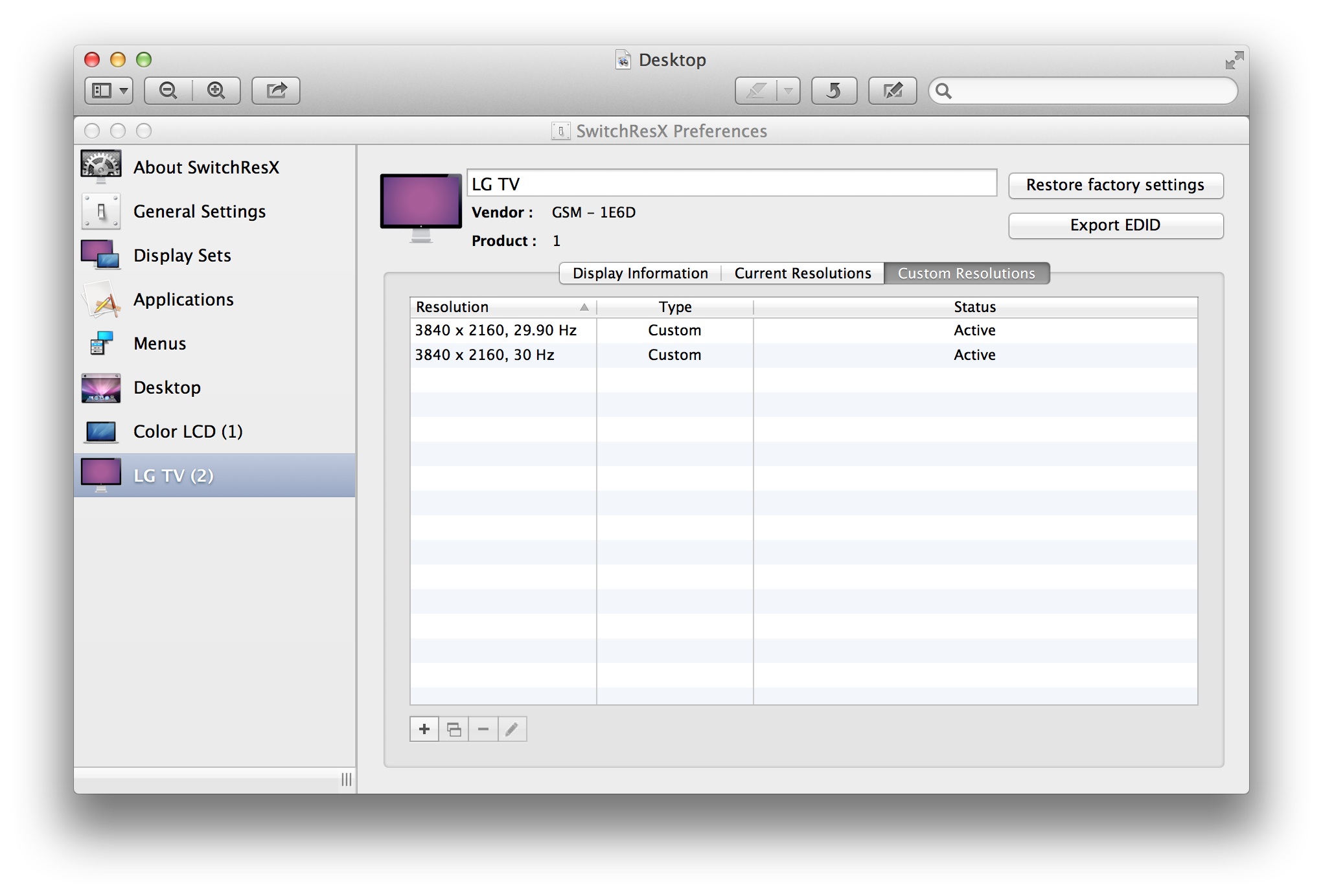

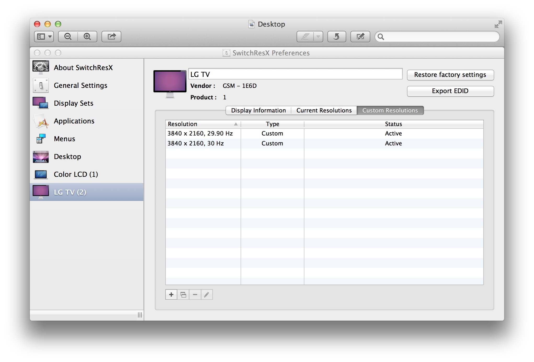

Nice! What did you have to use for the timings?
I'd also be curious if anyone ever manages to eak out > 30Hz from their displays. I think it should be possible to get at least 35Hz out of the mac / accel adapter, but cant get my display to ever lock that fast.
