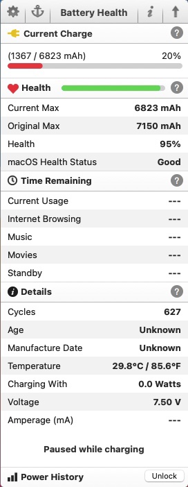

The reason I'm not giving up the old lady is because she's still in perfect condition. I swapped the SSD to 512GB Samsung about a year ago and the battery health is still at it's 95%.
Now I test it with another logic board and io board. Same problem. There’s only 3 things in that case: the two boards I already tested and the battery. The battery seems perfectly fine as indicated by the apps. Could it be something as simple as a faulty cable or what? Isn’t the battery simply connected by a 4-pin connector? Help needed!

If I disconnect the charger, the MacBook Air will turn off, meaning the MBA is on AC all the time. Hence the charging cable is fine, I guess. Wait, the battery can not power on the MBA on its own (with around 20% charge) which means either the battery or the battery connects to the logic board is faulty. Right? Then why all the apps say the battery is in good health?
I would put my money on either the battery, the power cable or the charging brick itself. And... apps can be wrong. I have a brandnew M1 Pro and all the apps give me different health numbers. If you hear hoofbeats, think horses, not zebras. The most obvious thing is often the case.
