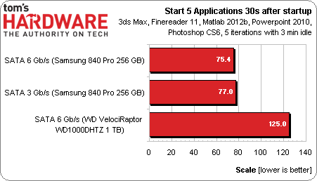

(Tom's Hardware review confirms that there is virtually no difference on boot + loading apps between SATA 2 and SATA 3 connection)

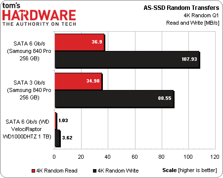

As you can see. The boot time affected only by small files read /write can't even saturate the SATA 3 bandwidth, therefore, PCIe speed is doing nothing in here.
(The 4k random read / write speed not even close to the SATA 2 limit 250MB/s. And this chart also shows SSD is 30 times faster than spinner in small files read / write. This is actually what a normal user need.)
