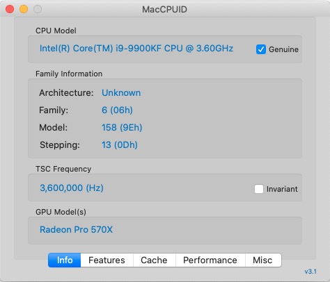

Other than Sidecar do you know any other software or tool that i can check my KF with.
I haven't sealed my iMac yet and have regular i9 9900k in my Gaming PC so i can swap.
Now it's just challenge for me to see =)
Before swapping my CPU i checked all devices thru the terminal to see if Intel GPU is presented,
i wasn't able to spot any traces of iGPU in to the system device list.
It actually was main reason why i picked i9 KF, got a very good deal on it.
I’m not really sure now. I thought Sidecar was used exclusively with the integrated graphics but it must not be the case. Is Apple whitelisting processors or would it have to do with which GPU you have?
I just used MacCPUID by Intel to check the info. Radeon Pro 570X 4 GB.
