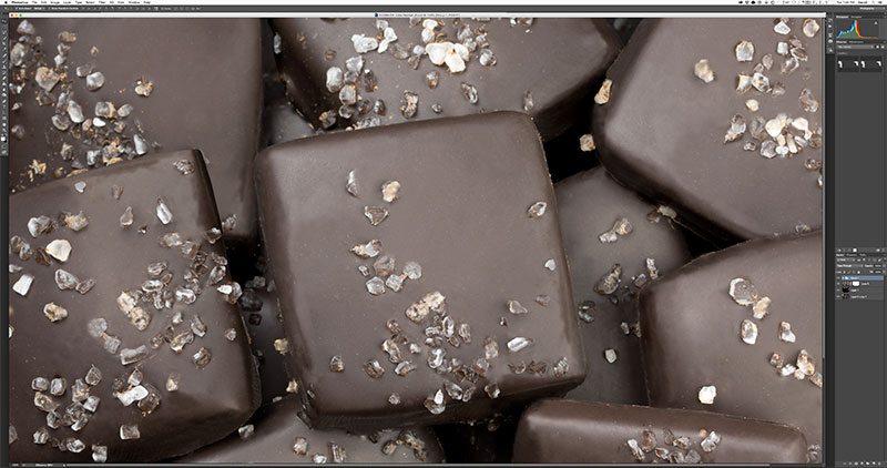

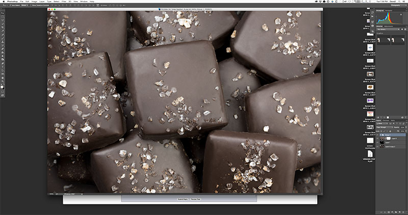

2. Maybe it's just this display but HiDPI isn't working correctly with Photoshop. From what I've read only the UI should scale, the images should be a native resolution. When running any scaled size the images I'm working on scale as well. For example a 5k image doesn't fill the screen at 150% scaling. At native its bigger than the screen.
Scaled:
Native:
