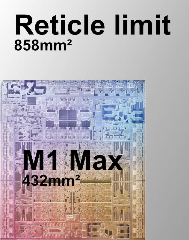

A monolithic M3 Ultra wouldn't be straight up twice the transistor count though. A lot of the blocks can be space optimised or entirely removed as there will be duplicates. Also you remove the entire UltraFusion bridge from both dies and all things that enable them to communicate across the dies. Seeing as the CPU and GPU clusters are now in close proximity on the same die you can probably reduce some local caches or the system level caches. Chop off two memory channels (512-bit to 384-bit) and use LPDDR5X to offset the memory bandwidth loss. That would also reduce the number of RAM chips needed from 8 to 6 while still be able to provide up to 288GB of unified memory (6 x 48GB).
Obviously there are reasons not to. The advantages of the medium sized dies fused together is yields and much better thermal control as the surface area is twice the size and heat spots are separated over the combined area. Not to mention power in numbers with the separate die shipping in a much larger quantity of products compared to the desktop chips.
It would be nice with a new high-end SoC for desktop chips at around 600-650mm² offering even more compute.

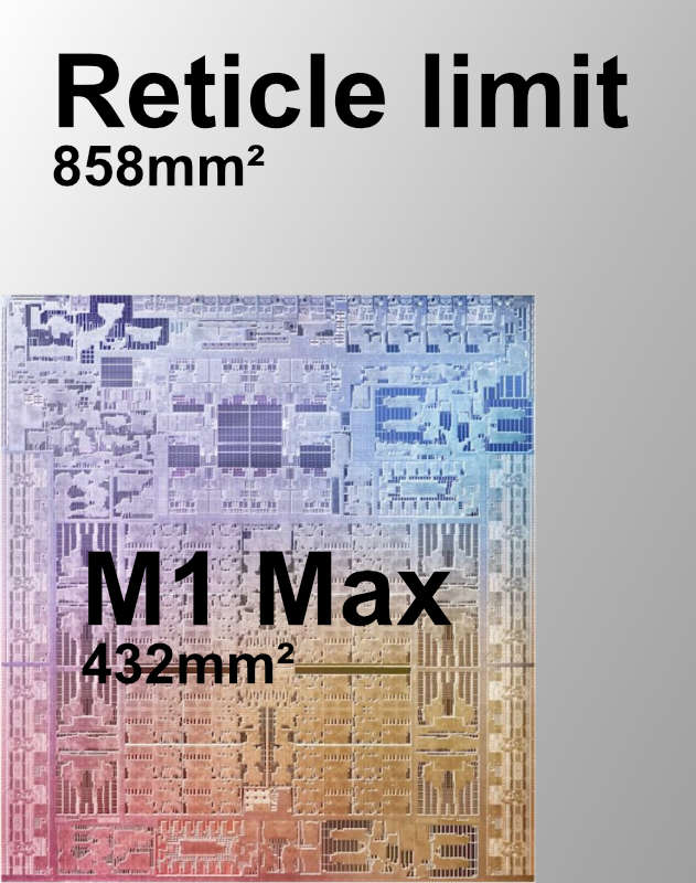

I made this visualisation of the reticle limit and the 432mm² M1 Max die only using 50.35% of that limit to show there are be plenty of room to increase die sizes.
That's a good point that the transistors used specifically to interface with the bridge wouldn't be needed. Though I don't know how much space that would save.
But I disagree with your proposed reduction in memory channels. As the Ultra has twice the GPU cores of the Max, it needs twice the bandwidth. Further, a key limitation of the Ultra is that it restricts Apple's top workstations to 192 GB RAM, which is not enough for some tasks. The switch to LPDDR5x should be used to increase both bandwidth and max RAM (and that's what I expect Apple to do), not as an opportuntity to reduce channels.
Not sure there is a real distinction between UltraFusion bridge and the inter-die communication. That is pretty much what UltraFusion does. It is a bit too narrow to label UltraFusion just as the static connector lanes/pads without the SERDES constructs and "internal network interface that go with them.
The 'redundant' blocks are the security enclase , SSD controller and a few other bits like that. (and perhaps the eDP connector for embedded display ... more vestigial than 'redundant' ). Most of the I/O is being used in Ultra also ( system port counts go up on Ultra Systems. I/O up. , etc. ).
Not really at all. Those larger local caches go a long way in keeping the inter cluster communication at high bandwidth and low latency; even on the same die. Toss those caches and tossing top end performance also.
The caches are to primarily avoid going all the way out to DDR RAM ... not to avoid going to another die in a Ultra configuration. Remove the 'other die' and still dealing with same DDR RAM latencies and bandwidth constraints.
Those memory channels are not 'redundant'. If chuck those from the die than chucking performance from the die also. It is already in the case folks hurl 'but it is not a 4090 or 7900XTX ' at the Apple offerings. Throwing more memory bandwidth out the window isn't going to help much. ( Yes Apple made some trade offs to make the M3 Pro do more with 'less' , but it isn't whipping the respective dGPUs it competes with either. )
AT the prices Apple charges the yield difference probably don't matter much. What probably matters more is just getting the project funded in the first place. Apple is looking for margins. Extremely likely, they are not looking to make chips with run rates in the very low 100's of thousands ( or less).
The MBP 14"/16" Maxes help pay for the Max. That's way UltraFusion is a bit of 'side car' tacked onto a monolthic chip. All those folks who didn't use UltraFusion at all helped pay for UltraFusion development for the first two iterations.
Using the same die in multiple products is a primary method in Apple's silicon efforts. Economies of scale matters. That is more major problem with the Ultra is 'scale'. Forked completely off by itself there likely is no 'scale'. Apple likely would need some 'desktop Max' volume to go along with the 'Ultra' volume to have enough 'scale' to get something of a mild fork done.
A maximum of 4 thunderbolt ports probably isn't going to work for a MacPro / Ultra Studio.
