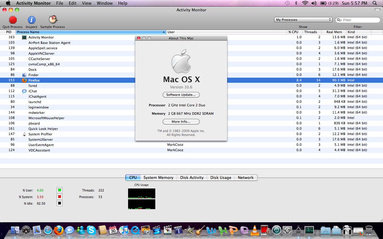

This doesn't really mean i'm running on 64 bit am I?
Nope.
Change "My Processes" to "All Processes" and check what "kernel_task" says. As said by me, and many others, it won't make any difference what mode the kernel is in for day-to-day work, as 64-bit applications and extensions are still fully supported. There are numerous reports that the MacBooks cannot even load the 64-bit kernel even with the 64 keystroke while booting, and to be honest, I don't care...SL is running great and does what I need it to, so that's that for me and my UMB.

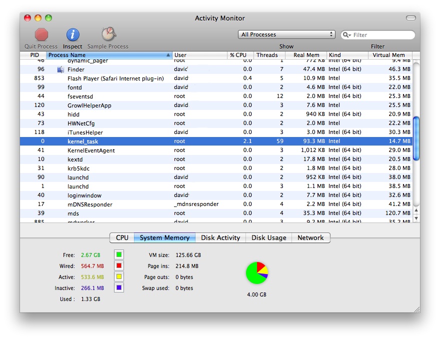

In the top right of the "Activity Monitor" window use the drop down that is currently showing "My Processes" and change it to "All Processes".
Then look for the process called "kernel_task". If it's 32-bit (Just saying "Intel"), you have the 32-bit Kernel. If it's 64-bit, you have the 64-bit kernel.
