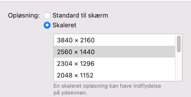

Yes, its still not there 🙄

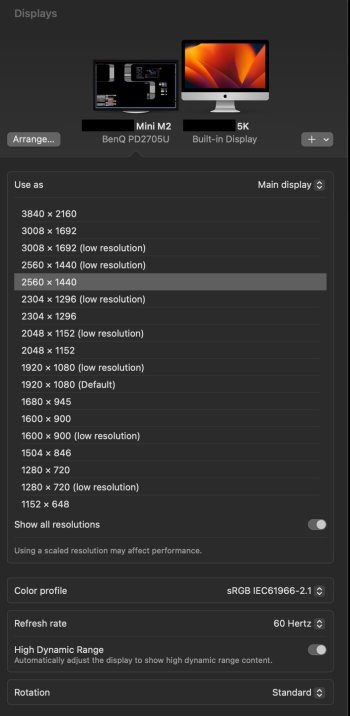

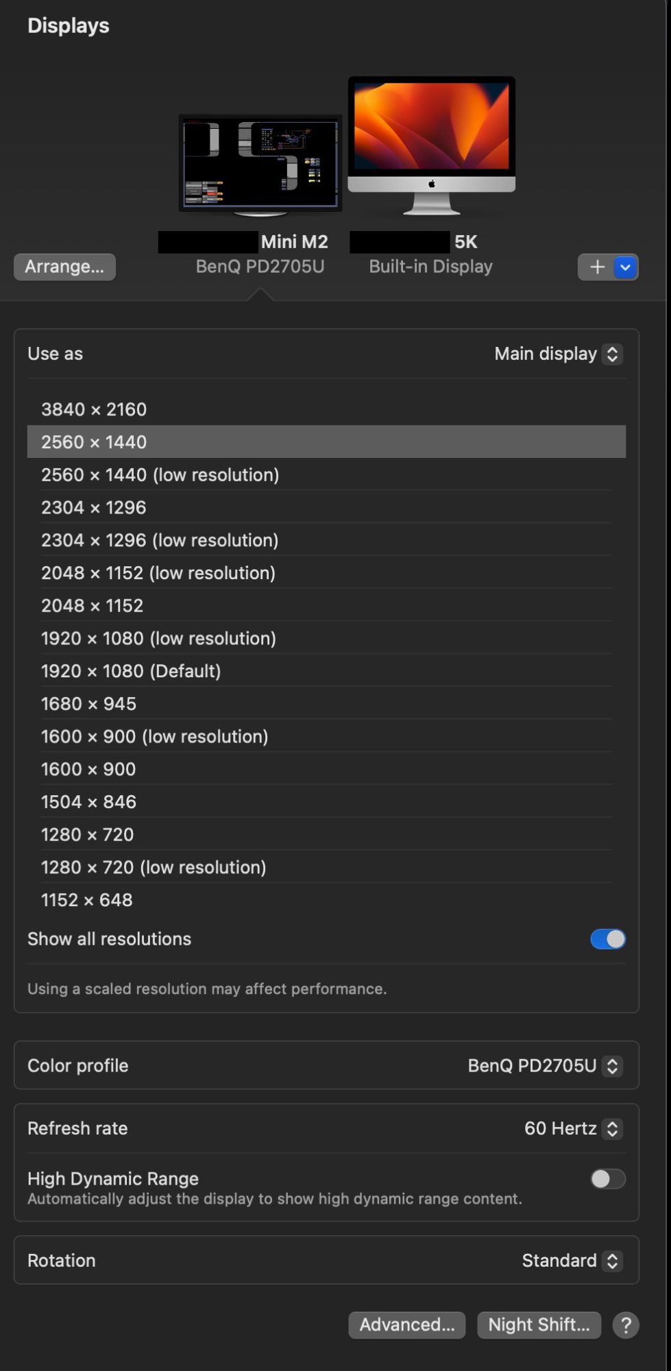

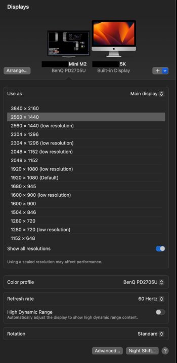

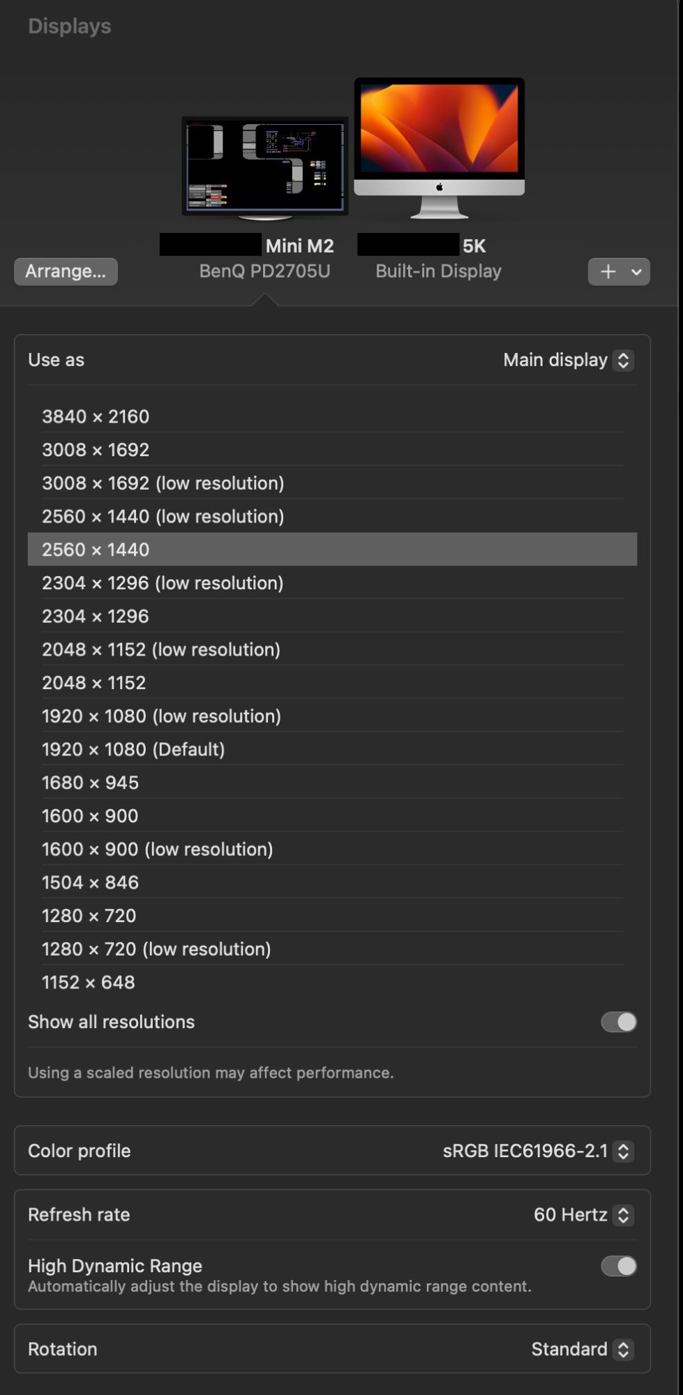

I have a Mac mini M2 - 16GB/512GB with a BenQ PD2705U display. and op is right that it will not run 3008x1692 through HDMI. left is HDMI right is USB-C
  • TB4:USB-C.jpg
