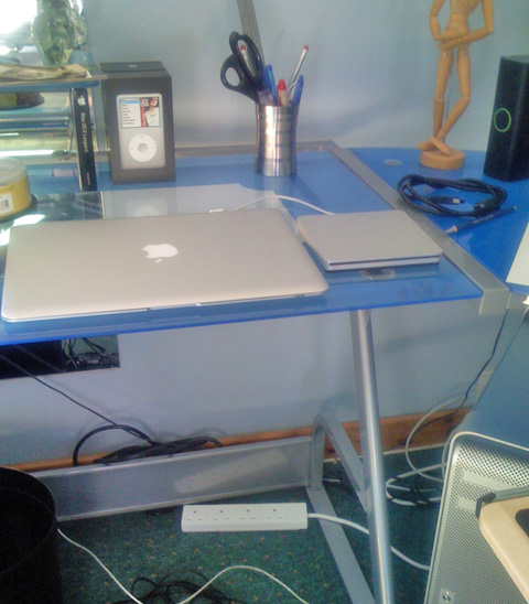

I have one and it DOES NOT work on a USB hub (I am running Boot Camp). I have tried it with several, powered and non-powered. This is a huge flaw, since it takes the only USB port. Ix anyone finds an XP driver to fix this please let me know.
I have one too.
I have tried in both powered hub and connected directly to another mac (a mac pro)
YES it shows up in another mac. BUT!!! try putting a disc into it. IT DOES NOT ACCEPT IT and remains dead.
TOAST can see the drive but not actually activate to use it at all.
The only way I can get the superdrive to work is to connect it 'directly' into the MBA's USB slot.
MBA and the 'Superdrive'.
