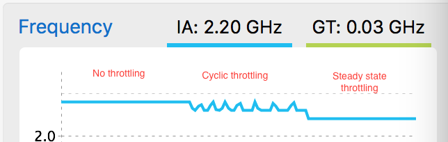

I have now got Intel Power Gadget (IPG) working, so have done some back-to-back tests with and without the Moshi case.
The method I used was to open Intel Power Gadget,with no programs running and wait until temp had stabilised. Then I started HIARCS deep chess in analysis mode and the stop watch at the same time. HIARCS deep chess uses 350% CPU in Activity monitor.
The sequence of events is then:
1. The CPU turbo boost immediately goes to 2.4Ghz (why not 2.7GHz as spec?) and the temp rises rapidly flattening off at about 92 degC (see screenshot)
2. CPU stays flat at 2.4GHz with the temp at about 92 degC.
3. At this point the CPU starts being throttled to 2.3 Ghz, but cycling between 2.3 ad 2.4 (see screenshot) with temp down to 89 degC.
4. After a short while the throttling becomes steady at 2.2Ghz and the temperature drops to 84 degC. This appears to be a steady state showing no further change after 15 minutes.
I did six runs, three with Moshi case and three without. The main measurement I took was the time to reach the steady throttling state of 2.2Ghz and 84 degC. Longer is better.
With the case the three times were 4 mins, 2mins 50 secs and 2 mins 40 secs.
Without the case the times were 6 mins, 3 mins 20 secs and 2mins 30 secs.
Quite a bit of variability, but the without case results include the fastest and slowest time to throttle, but on average it takes slightly longer to reach the steady state throttled state without the case.
My overall conclusion is that there is no temperature related reason not to use the case.
