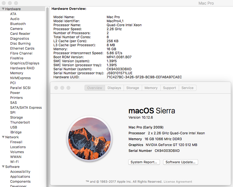

However: Another bit of weirdness - though I have flashed the 4,1 with 5,1 firmware, and I am running Sierra (10.12.6), System profiler still shows MP 4,1. I did not think a 4,1 would run 10.12.6.
Any screen capture for that?
Here it is:

I don't think your system "flashing" worked. I've flashed my 2009 4,1. The About this Mac screen still shows it as a 2009 model, but System Report-Hardware Overview shows 5,1.

Your Mac Pro still 4,1, not 5,1 yet.
1) Did you perform the 5,1 firmware flash by yourself?
2) Did you install Sierra by yourself?
And for your info, 4,1 can install Sierra, just need a little bit of work around.

You need to disable SIP for firmware flashing. In fact, I recommend you install Mavericks / Yosemite (any OSX that doesn't have SIP) for 5,1 firmware flashing.
If last time you use this HDD, try another one. I never had this issue, but quite a few users here mentioned they can't perform the firmware hack, and eventually all they need is just another HDD.
When I used Mountain Lion (10.8.5) freshly installed on a drive in a 4,1 Mac Pro I didn't have to do anything other than copy the firmware flasher to the machine, make sure it was connected to the Internet, and open an image of the firmware on its desktop.
Was finally able to update the firmware. It simply did not like the Seagate drive I was using. Switched to the WD Black, disabled SIP, and it updated. Enabled SIP, and it is up and running.

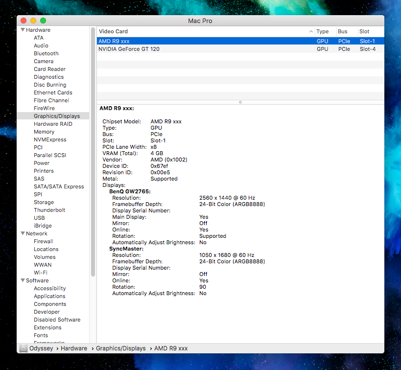

FYI - I've just put a RX 560 in my MacPro5,1, running macOS 10.13.2. Obviously no boot-splash, but it seems to run alright. I don't really know if this card's running particularly well for what it is, but it seems to run Starcraft II quite well.
I'm a bit concerned how it comes up in System Information though, here it is (minus serial numbers):
Prior to the RX 560, I tried an RX 550 and that GPU was listed at all in System Information, but it wouldn't drive displays. So basically for the 550 was entirely a non-starter. I won't want to have to resort to Hacintosh kexts just to get a newer GPU going on my otherwise fully supported MacPro5,1. I'd consider a 570/580, but they're not really realistically available to me.
I've only used this for a few rounds of SCII, but so far it's driving my 2K display (plus secondary display) just fine. The feels like decent upgrade from the 5770 I've used since, what feels like, the late 1960's.
All indications suggest 10.13.4 will fix the GPU name. But just so you know, it’s entirely cosmetic.
