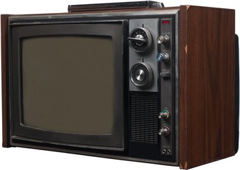

So for the background I would like an old TV (70's era) in the right hand side. It is all black surrounding the TV Except for its flicker once and awhile illuminating the wood floors in front of it.
Would anyone be able to make this? You would get credit on the short plus a copy of the short.
Something like this is what I am going for in regards to the TV's look

Did you find that image? Or was that an Image i posted? I probably should find a way that I can get the rights to it because we will be putting this short in film festivals.

The image of the television was the one you posted here.

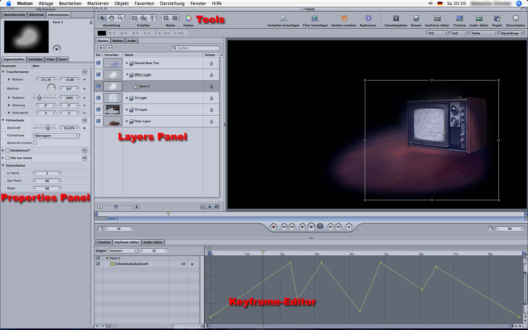

If you have Final Cut Studio then you have Motion! You can download a zip file (ca. 400kb) with a motion project that does about the same thing that I did in PS at http://www.zimmerfamily.de/sebastian/motion/tvdvd_blue.html.
Check out the different Layers, Filters and Masks I used to get the effect. Feel free to alter it in any way you wish.

and you might be well advised to go buy AE 7 when it goes universal (if that matters to you). Photoshop can do some cool stuff, but AE is AWESOME at doing the type of stuff you would want to do with complicated dvd menus...
As you know, motion is a layer based none linear video editing and effects program. This means you can do alot of the same stuff you can do in Photoshop (a layer based pixel editing program), except that you have the added abilty to change properties (or effects) over time.
In this example I used keyframes to controll property settings over time. I did this on purpose because most people find in easier to 'see' what is changing (graphical timeline). Motion however has a much more powerful method, called behaviors. There are some good video tutorials on the apple website and on the dvd included in Final Cut Studio, take a look at them if you are interested and want to learn more.
Anyways, for the lighting I:
  1. created a new empty layer
  2. drew a custom shape using the pen tool; fill color white, overlay blending mode, and soft edges
  3. set keyframes to changed the opacity of the shape over time
Thats it! 🙂
I did the same thing to the shadows but I also changed their size of time.
Once you get the idea its all really easy, like I said in took maybe 10min. (of course you could spend hours to get it perfect)
Take a look at the 'Layers panel' and twirl down all the arrows to see what effects I applied. You can see the keyframes in the 'Keyframe-editor' and all the other properties in the 'Properties Panel'. You can use the tools at the top to draw shapes, make masks, zoom, etc.
If you have more question feel free to ask and have fun.

Wow thats amazing. Definitely gonna have to stop putting of the Final Cut Studio Tutorials and DVD help!
Ok crap heres the question now:
I took the image from out of motion and set it in to DVD Studio Pro. The problem is is that it keeps laying the image as a square image and not filling the whole background...
The Image is also messed up. It looks also very weird. It comes out with out the blue filter.
What do you think I should do?
EDIT: Oh wait I figured it out... Duh me... Export.... and its perfect. Now the problem is I have to fix the timing. Its moving to fast.
Sounds like your DVD menu has a 4:3 aspect ration, the motion project I made is in 16:9.
It's an easy fix though.
Find out exactly what the size and fps of your DVD menu are suppose to be.
Then create a new motion project with those settings. Most likely one of the preset will be fine but check just to make sure (Edit<Project settings).
Then go to the motion project I made, in the Layer panel, select all the layers, Edit<Copy.
Go back to the newly create project.
Edit<Paste (This should put everything into one new layer, containing lots of sublayers)
Select just that new layer.
Hold the shift key to sustain proportions and scale to the size you want it.
When your finished, export a quicktime movie. You can then easily use this in DVD Studio Pro.
