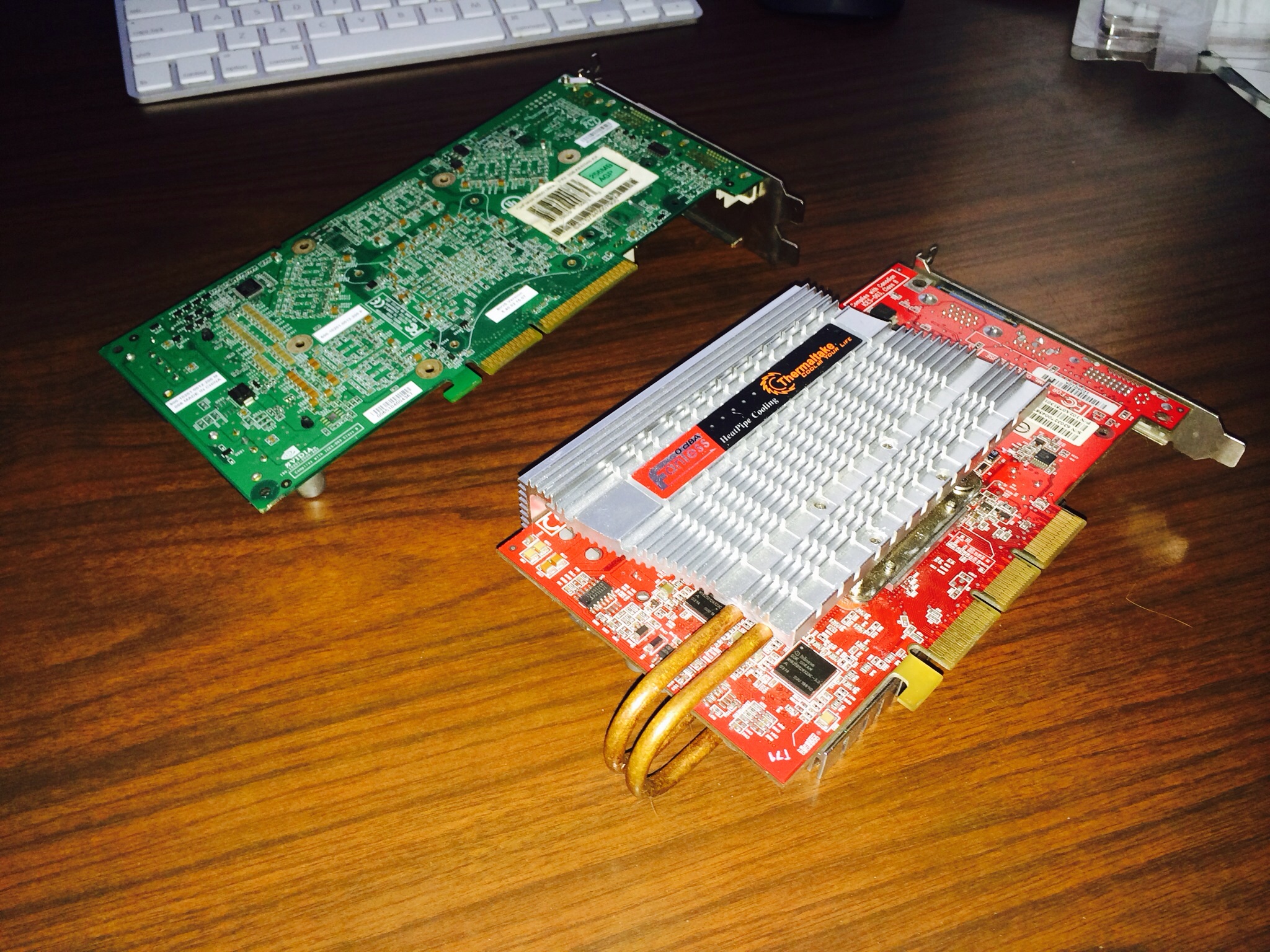

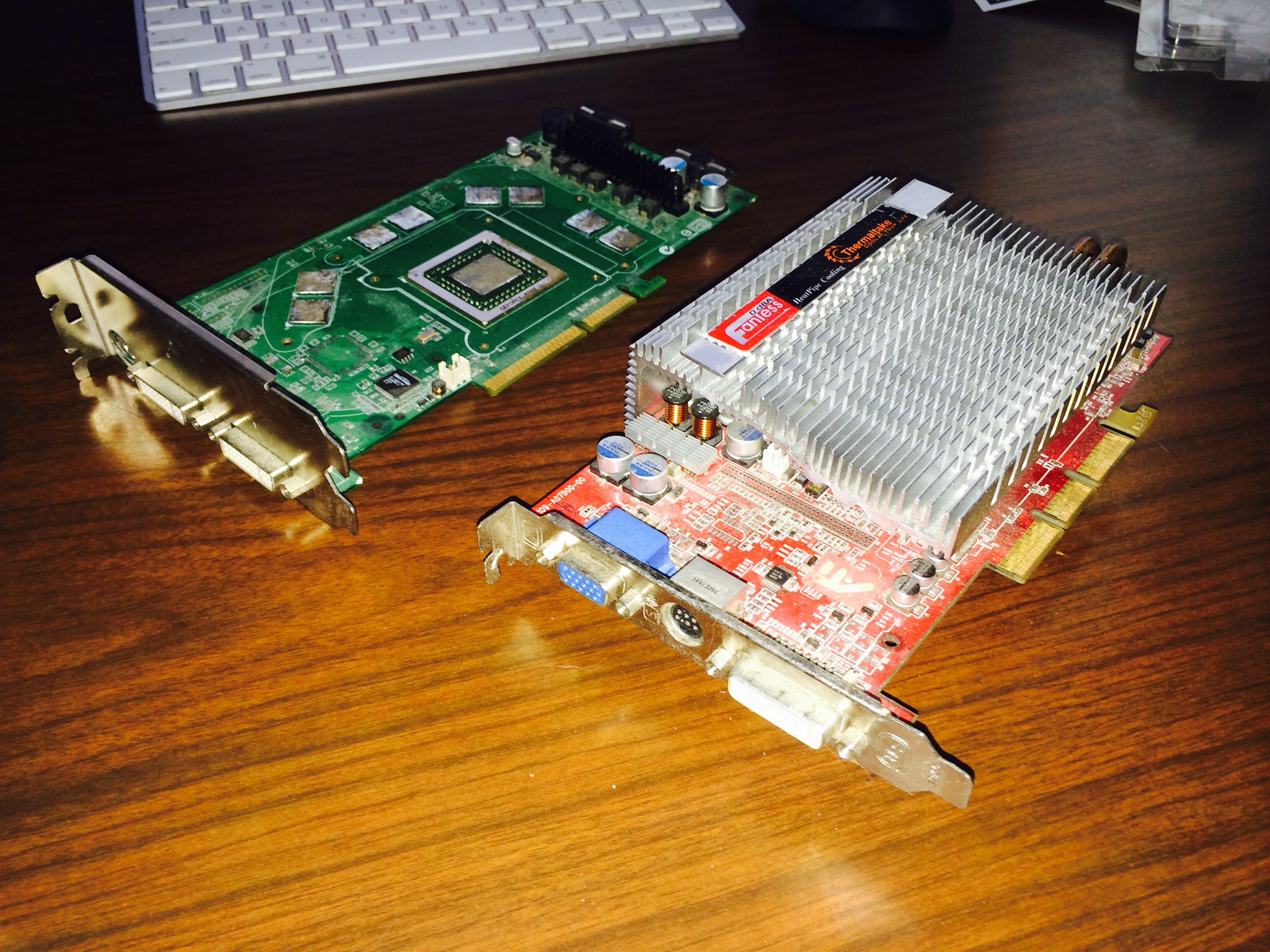

Added:
Hey I even found an 6800 ultra 256mb. I think I used that one in my G5 AGP. It's been so long ago, it's missing the cooler since I think it was making noise and why I removed it to replace but never did. If you want to mess with them, you can have them both.

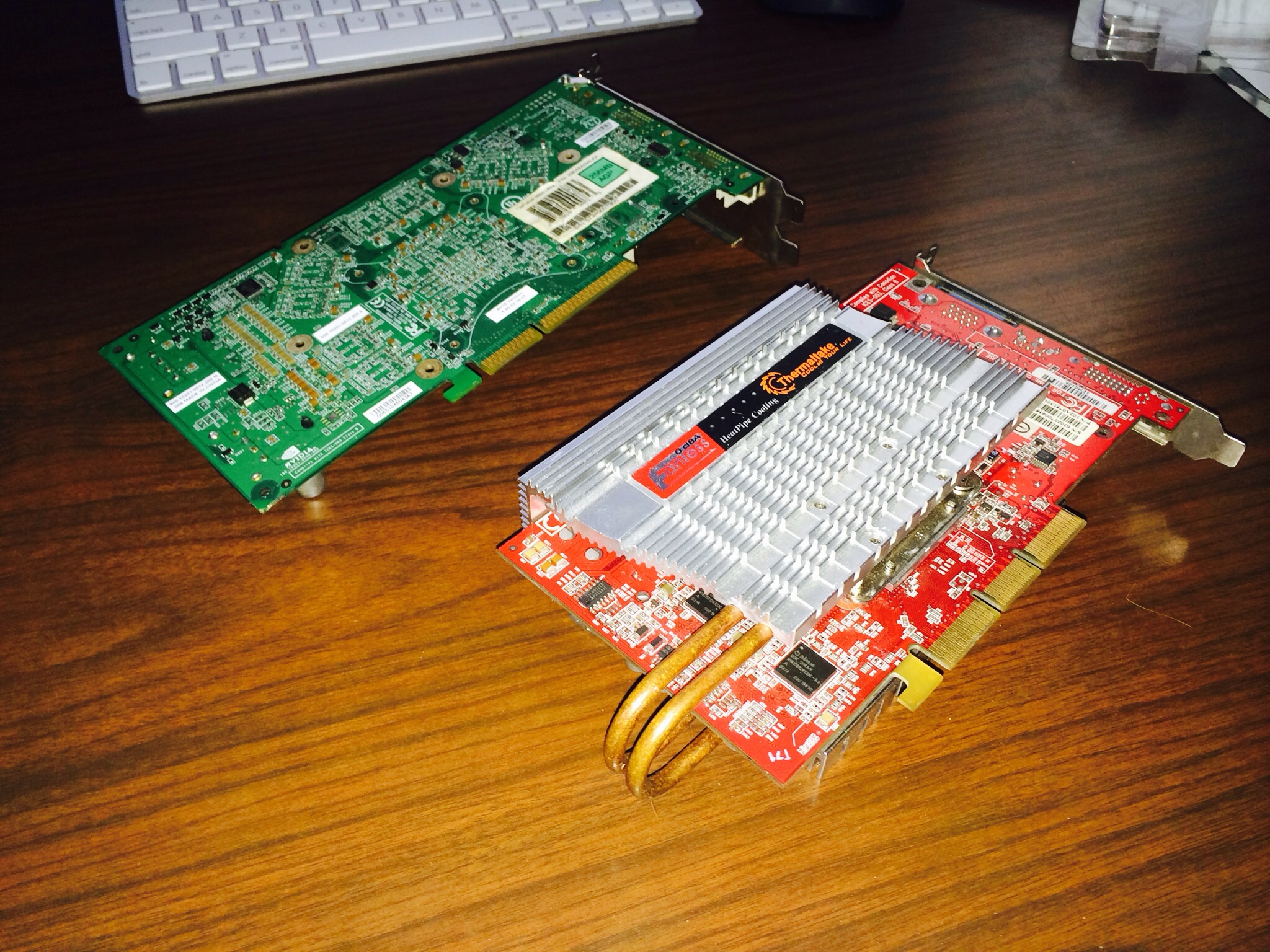

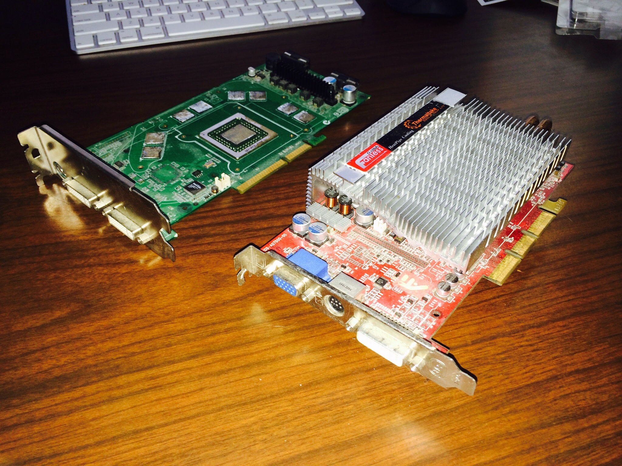

Here's the other photo since MR won't let me upload more than one photo at a time. I don't know if they work or not either so if you want to mess around with them you can have them.
I'm interested if Goftrey is not. Sent you a PM. 😀
Yeah, I see he's in the UK. Shipping/VAT might be too high 🙁 But if he passes, they are all yours. I'd like to see them go to a good home that could use them(if they work lol) At least the cooler would be worth it IMO. It was awesome and no sound!
