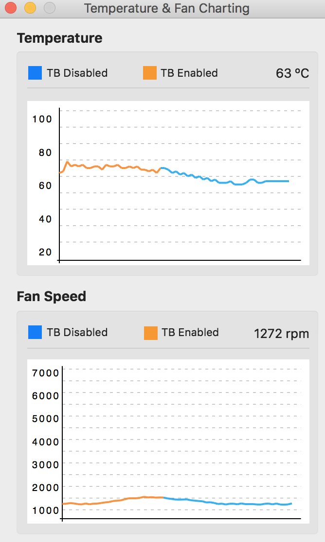

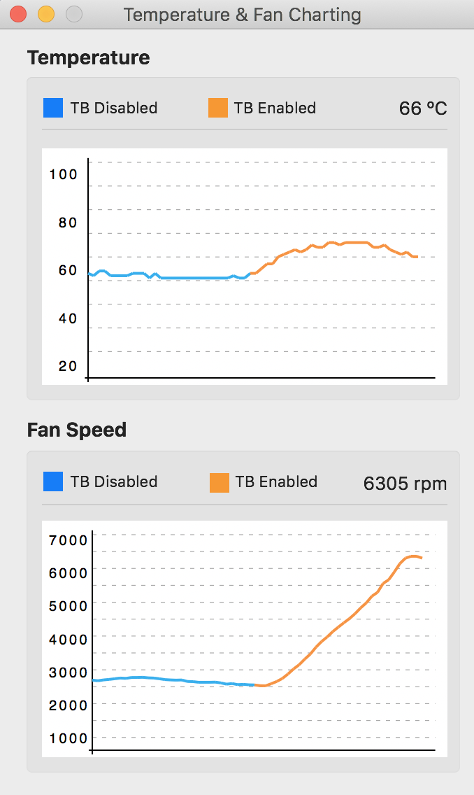

Thanks for the replies. According to my unscientific test (by trying out the same setup under Mojave and Catalina), I've discovered the following:
- the MBP obtains the same temperature using Mojave or Catalina for about the the same amount of load. If turbo boost is enabled, it runs around 60-70 degrees.
- BUT: Catalina treats this temperature vastly different, spinning up as way before Mojave.
This is shown by these two graphs from Turbo Boost Switcher:
Mojave: (a) the temperature is running between 70-80 in turbo-mode and 65-75 in non-TB. (b) BUT the fan is running basically with the same speed all along (1500 or so).
Catalina: (a) the temperature in non-TB is close to 60 and raises only to 75 in TB-mode, at no point higher than under Mojave - (b) BUT the fan is running at a completely different speed: from 2500-6000!
CONCLUSION: It seems that Apple changed their tolerance in regard to temperature forcing the fans to cool much more at similar temperatures in Catalina compared to Mojave.
I do for this reason not think it will go away over time. I did leave it for a day or so to index, but the fan noise remained. This is "politics". Perhaps there is a good reason for this change, but I am really curious to know, if someone else discovered the same change of behavior going from Mojave to Catalina.
