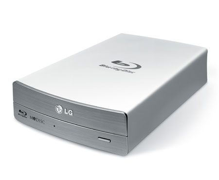

    http://www.lg.com/us/data-storage/lg-BE14NU40
    [​IMG]
    [​IMG]
    I am looking for a USB 3.0 powered blu ray burner for my 2012 27 iMac. I really like the look of this one (white with brushed aluminum front) since it will match up well with my iMac and Airport Extreme. Also, it is AC powered so I don't have to take up multiple USB plugs to power it. Plus, it's fast.
    However it doesn't list Mac compatibility. Can you think of any reason it shouldn't work? I know it won't natively play blurays, but I really only want it for a burner since there is no internal drive in the iMac anymore. I suppose I could always buy bluray player software if I decided to watch the movies on the iMac.
    Has anyone tried this model, or any other similar LG external burner with success?

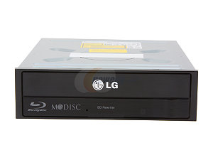

    Here is what I plan on doing if I don't buy the LG discussed...
    LG Drive:
    http://www.newegg.com/Product/Product.aspx?Item=N82E16827136250
    [​IMG]
    Firewire Enclosure:
    http://eshop.macsales.com/item/Other World Computing/MRSFW8U2OB/
    [​IMG]
    Total hardware price of $120. Not as pretty as the 3.0 LG on this page though.
