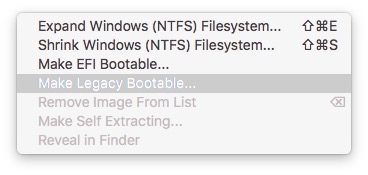

Followed this guide to the letter, only part/option I did not get was - Copy Boot File - Part 24 of the guide.
Did you try this option?
Yup did that to no avail.
