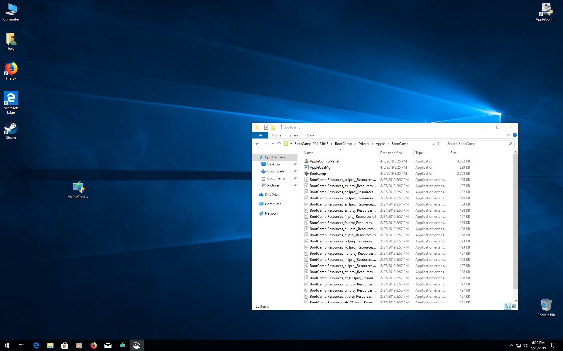

Again I'm not actually installing the iMac Pro bootcamp software. Simply downloading it, and extracting it.
In the screen shot I have attached there is the extracted iMac Pro bootcamp software that I've just placed in my documents folder, and created a shortcut on my desktop. Its as simple as that. All I use it for is to boot back into Mac OS.
[doublepost=1558663964][/doublepost]So it just finished installing. So far so good, no BSOD. Looks like I'm still in AHCI mode as well. Bootcamp was the problem.
