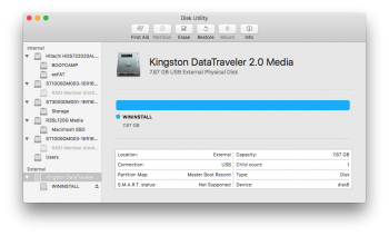

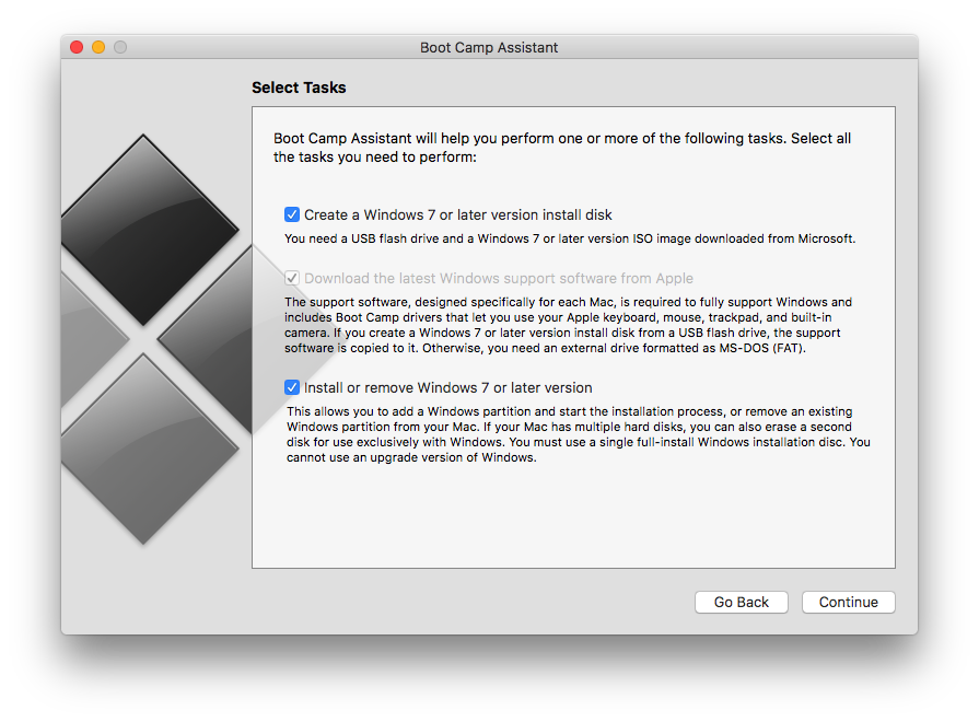

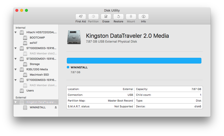

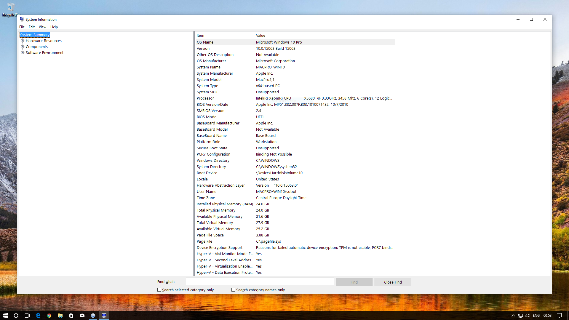

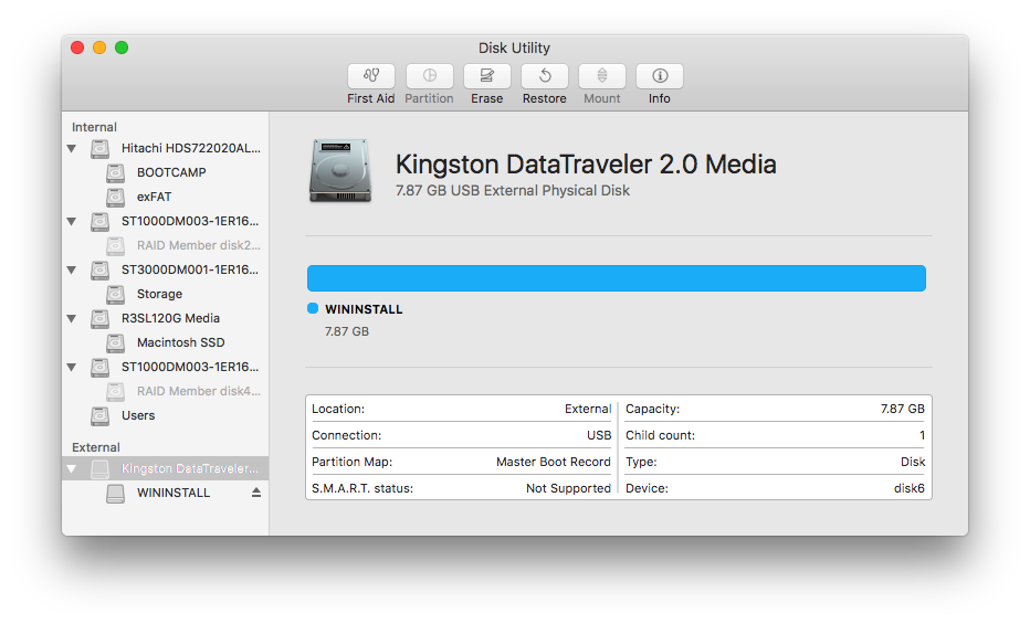

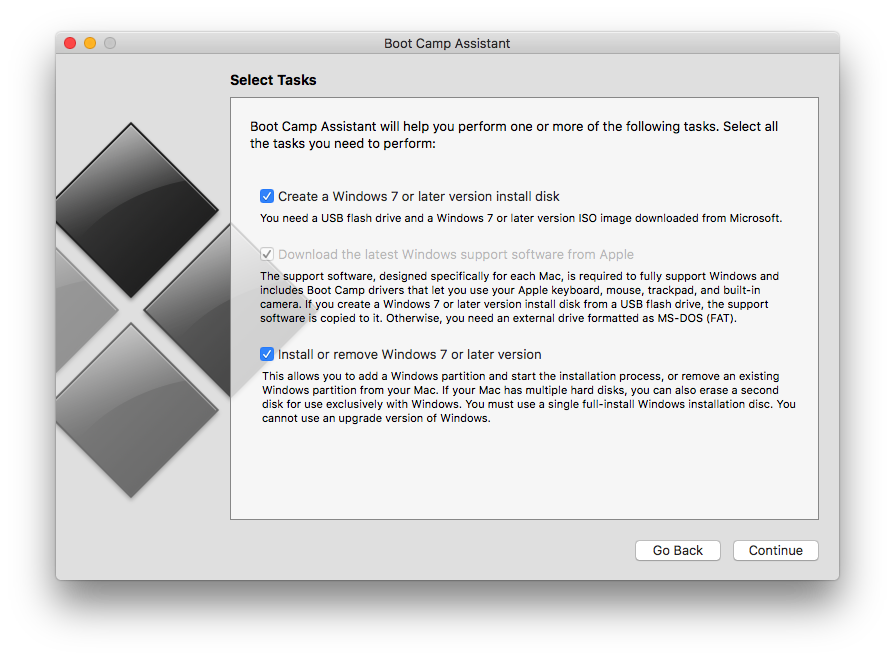

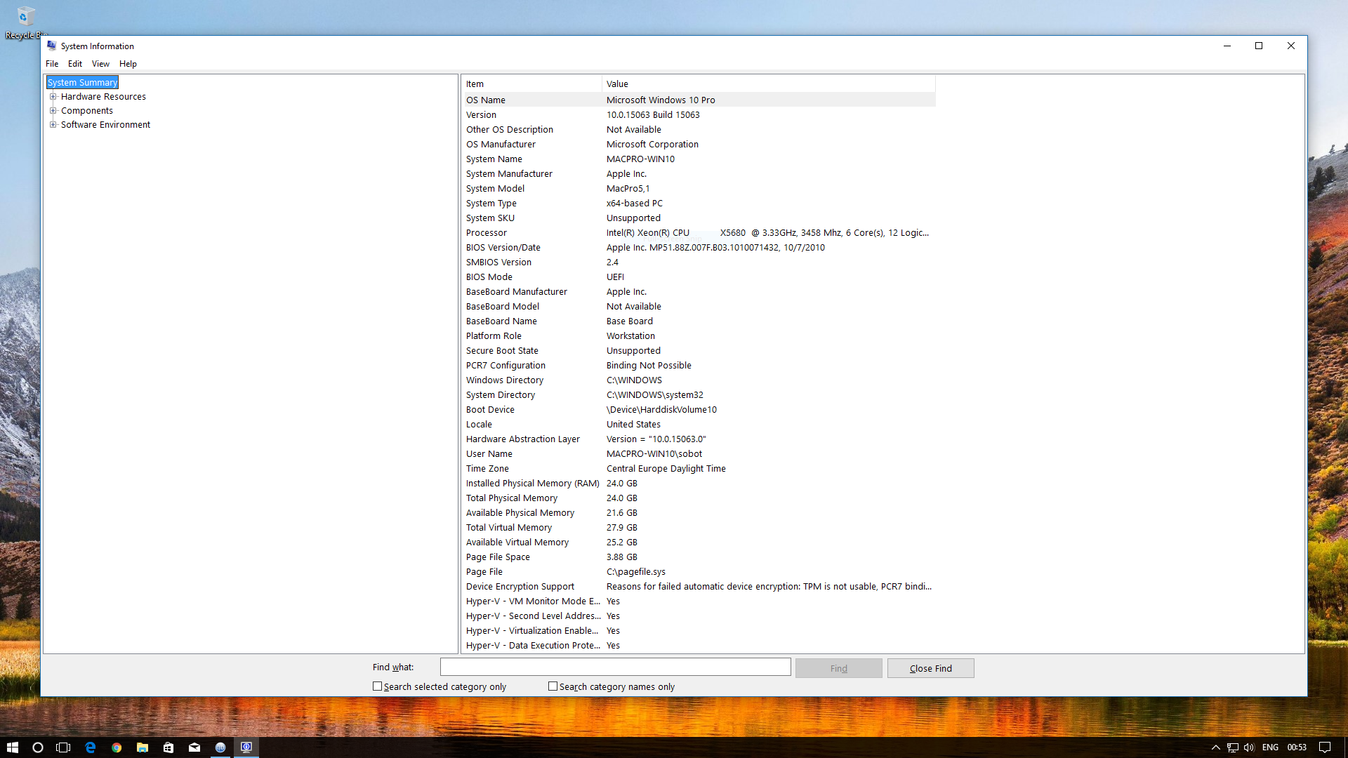

Hey sorry for being a month late to reply, but better late than never 😀
Burning a DVD might be the easiest way (though it never worked for me booting in UEFI mode, just CSM), but i always seem to have none left when i need them the most, so i figured out the BootCamp UEFI install by just messing with plist file - I always have a 8GB USB stick around. I said "i figured it out" because I choose not to follow any online instruction for it (and there are plenty on making USB installation stick if your Mac have Superdrive also), since every version of Bootcamp has different entries in plist and all I could google at the moment were ML/Mavericks guides.
So, without further ado,
You basically just go through the plist removing all MacPro5,1 and MacPro5 lines from it (I've left MacPro2,1 etc since they're of no interest to me or this method).
After that, you'll have one entry/line or string 🙂 with MacPro6,1 - the only MP that supports Win EFI boot.
You just delete 6 and put 5 there, so that string now reads MacPro5,1.
For Sierra 10.12.5 it is in PreWindows10OnlyModels.
Now go to BootCamp Assistant, and you'll have option to make USB installation stick that will boot into EFI mode (although the stick will be Master Boot Record instead of GPT, it will work flawlessly).
Screen Shot 2017-07-17 at 9.43.46 PM.png msinfo.PNG Screen Shot 2017-07-17 at 9.45.39 PM.png
I am attaching both plist files for you to go through them and see what I did, but I encourage you to do your own edits if you're not on macOS 10.12.5 and therefor probably have different Bootcamp version and different info.plist file.
Also, one more thing, BC Assistant will download Bootcamp 4 for some reason unknown to me.
Download from Apple's website version 5.1. and save it to the thumb drive or DVD.
https://support.apple.com/kb/dl1720?locale=en_US

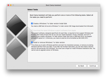

View attachment 708994 View attachment 708995 View attachment 708996
