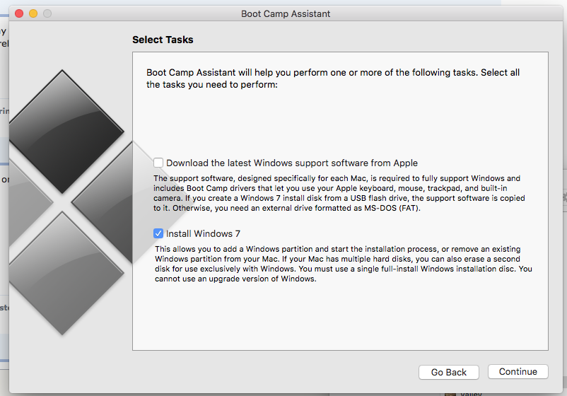

Here's what I get when I run El Cap's Bootcamp Assistant:
Note that there's no option to create media from the ISO image I downloaded. That's what the various links around the web said to do, but they're not running El Capitan on a Mac Pro 2,1...

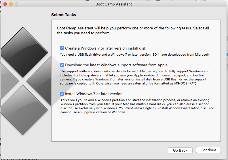

Tada! "Create Win 7 or later install disk" is enabled on my antique MacPro". 😀😎
