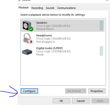

Goto- Control Panel--> Hardware and Sound---> Sound
Underneath, "select a playback device below to modify its settings" -- Make sure speakers are highlighted ( single left click makes the speakers shaded blue)
Click the configure tab at lower left corner .
Change from stereo to quadraphonic or surround.
That solved the problem of low volume on my mac.
